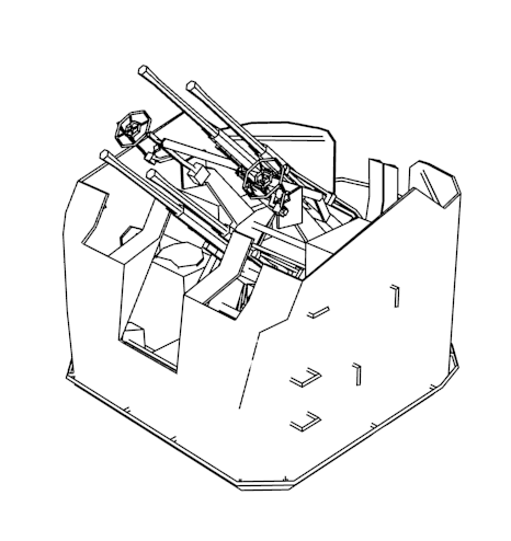

The Soviets actually had a quadruple 25mm mounting which was designated firstly as BL-120 and then (after the fall of Lavrentiy Beria, as 'BL' stood for his initials) 4M-120. Two such mountings were actually installed in 1954 aboard the 'Neustrashimy' destroyer (Project 41) besides four SM-16 twin 45mm stabilised mountings. After a short time all those AA guns were replaced by four 'standard' SM-21 quadruple 45mm (not stablilised) mountings.
Below you've got two drawings of the BL-120/4M-120. Unfortunately I've never found any photos showing the mounting.
Is there any detailed drawing of the RYS-U fire control system, intended for the quadruple 25mm BL-120?
