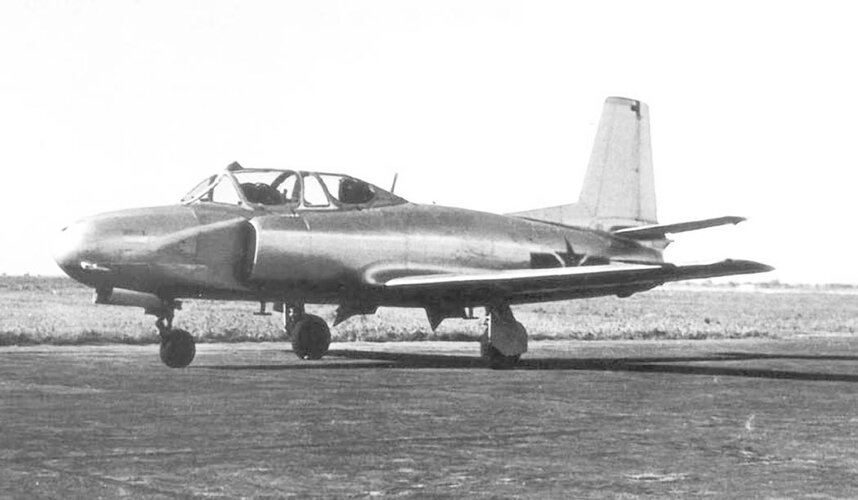

Do you have any pictures of the MiG-15UTI Mod ?
From 《中国飞机全书》, I think that's a book of high authority.
The text in it:
……In 1958, in order to meet the need for training missions in aviation schools and the troops, the Air Force decided to convert the MiG-15 fighter into the MiG-15UTI two-seat trainer. The first aircraft was converted in November, and the follow-ons began in 1959. The Air Force called the converted ones "MiG-15UTI Mod" (乌米格-15改) distinguished from the original MiG-15UTI (乌米格-15). In September 1960, in order to solve the lack of RD-45 engines, some MiG-15UTIs were equipped with the USSR's VK-1A engines. In 1967, it was decided that the first 150 MiG-15UTIs would equipped with domestic WP-5B (涡喷-5乙) engines before 1969. The original MiG-15UTIs with different engines were called "MiG-15UTI Mod Engine" (乌米格-15改发). The two-seat trainers converted from the MiG-15s but with different engines were called "MiG-15UTI Mod Mod Engine" (乌米格-15改改发). MiG-15UTI was decommissioned on 8 August 1986.
The photo doesn't have any caption, so I don't know which variant of the MiG-15UTI.
