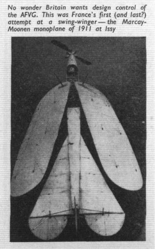

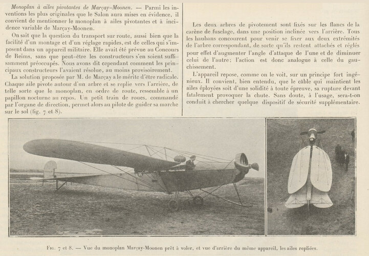

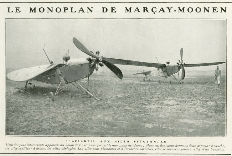

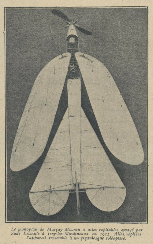

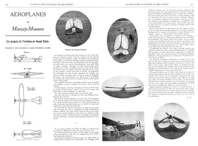

The first de Marçay heavier-than-air aircraft was designed with Emile Moonen. The 1911 de Marçay-Moonen monoplane was the first to feature folding wings for transport and storage. Together, de Marçay and Moonen had filed UK Patent 18,661 "Improvements in and relating to Aeroplanes and other Machines" in Oct 1909, describing the folding wings.
In 1912, Edmond de Marcay and Emile Moonen also proposed an oblique wing design for the first time. [1] "The idea was to vary sweep of oblique wings for landing in sideslip." [2]
[1] Hirschberg, M., D. Hart, and T. Beutner, A Summary of a Half-Century of Oblique Wing Research, 45th AIAA Aerospace Sciences Meeting and Exhibit, AIAA Paper 2007-150, Jan. 2007.
[2] "Conceptual Assessment of an Oblique Flying Wing Aircraft including Controls and Trim Characteristics", Ryan W. Plumley (Masters thesis), 2008, pg.3

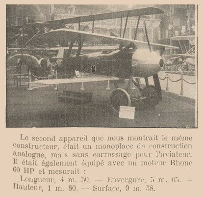

From 1916-to-1918, Anonyme d'Etudes et de Construction Aéronautique Edmond de Marçay in Bordeaux built 400 x Spad VII C1s but there is no sign of special designations applied.
Later designs are assigned exclusively to de Marçay. But, in L'Aeronautique 166, mention is made of a M. Botalli associated with the engineering of a monoplane tourer designed by de Marçay (presumably the de Marçay T-2). And a long-term association between de Marçay and Botalli is implied.

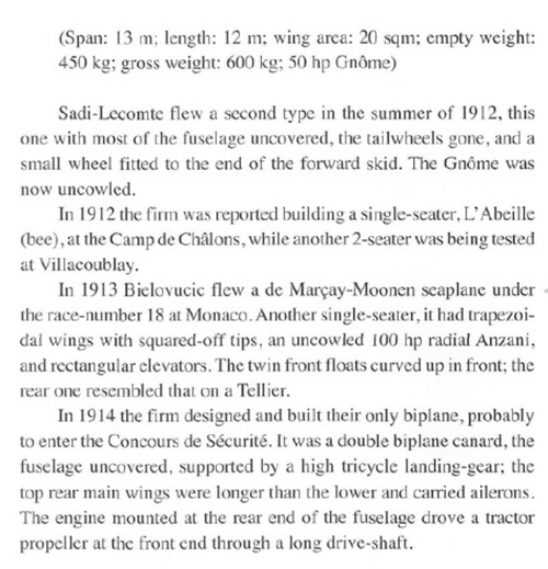

An exception was the 1912 de Marçay-Moonen L'Abeille ('Bee') ... although 'abeille' may also have been an early useage for light aircraft akin to 'avionnette'.

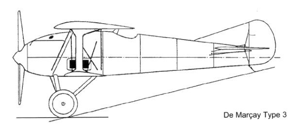

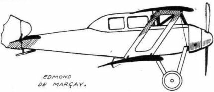

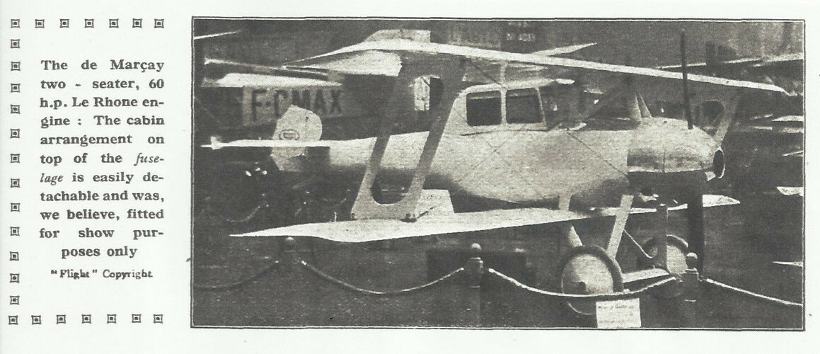

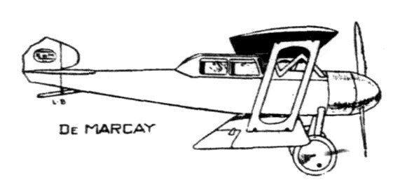

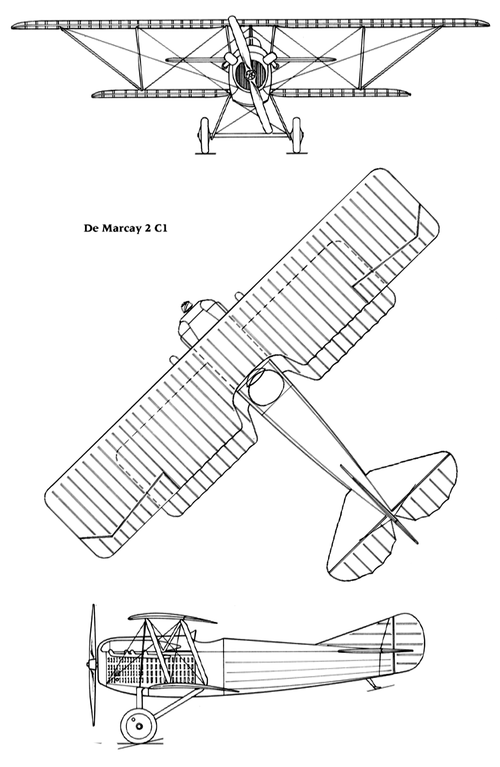

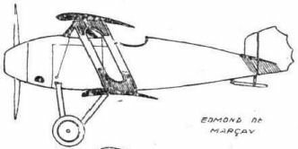

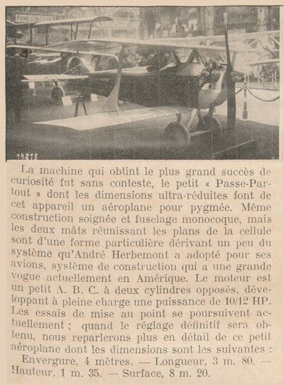

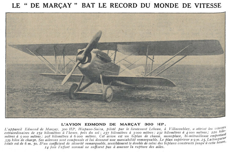

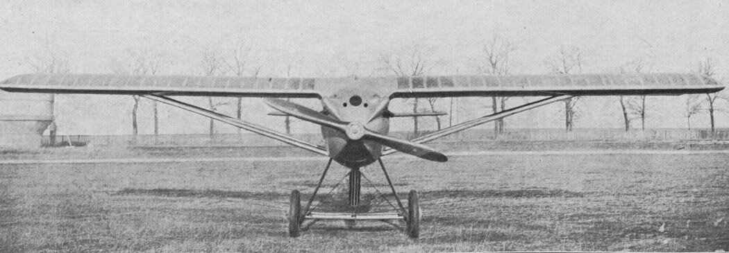

After WWI, de Marçay types were given numbers. Only four numbers are known ('3' is missing) but there is a numeral repetition with the 1919 de Marçay 2 C1 sesquiplane fighter and the 1920 de Marçay T-2 monoplane tourer.
I have also seen the de Marçay 2 C1 fighter described as the 'Type C'. I assume this to be a generic term -- 'C' being for 'Chasse'.
At this stage, I run out of de Marçay projects. So, was de Marçay an enthusiast financier. Or was he an amateur aircraft designer in need of engineering assistance? Can anyone help untangle the naming/designation mess? Can anyone add any other de Marçay aircraft designs?
