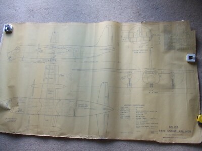

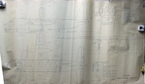

I'm hoping that a SPF member will have the winning bid on those drawings. But just in case ...
Remarkable resemblance to the F-27. Conceived in 1958 acc. to Air Enthousiast, the F-27 had by that time already been flying for 2 years and first production aircraft were being delivered to Air Lingus in '58. Why would DeHavilland want to start such a project like this?? Any theories in this?
I suspect that it was because DH thought they had access to a better engine. AFAIK, Dart and Gnome sfc is about the same ... but the latter weighs less than a third of the former.
My dear Apophenia,
it is real one,the DH-123 was re-allocated to this concept.

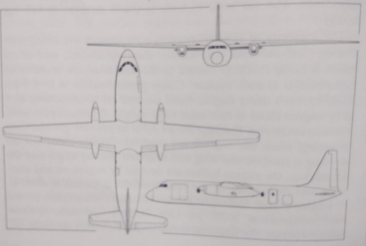

Again from Putnam book.

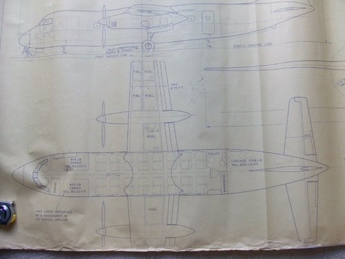

Small update on this... I haven't forgotten... drawings are stored safely, I'd hoped to scan them when I got back into work after lockdown, but ended up having to put all my archiving equipment into store due to building works... Im going to be recommissioning the kit in the next couple of weeks... so the hopefully soon!
Zeb
