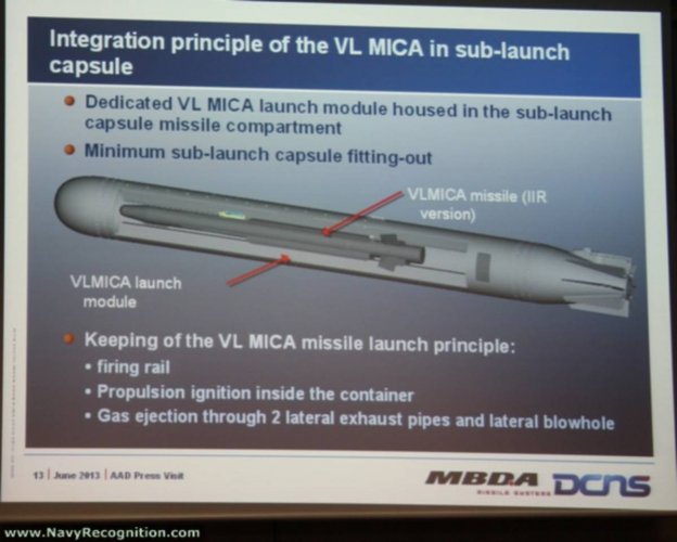

Underwater vehicle version: Comprises a torpedo-like capsule containing a medium-range (20 km) Mica missile that is tube-launchable at any depth. The capsule is similar to the type developed for submarine-launched Exocet anti-ship missiles.

The mast version isn't very different from SLAM, proposed and tested around 1974. So, there
actually was an alternative for just fleeing and hiding, but it seems not to have been considered
worthwhile. Maybe because at least the mast mounted version gives away the subs position, when
it needs stealth more, than every thing else. And a shot launched from a torpedo tube probably
isn't that much better.
