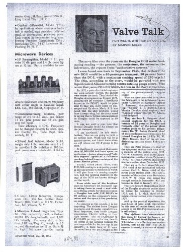

Hi Skybolt!
pre DC-8:
Douglas Model 1278, "familiarly know as the DC-8", 4 turbojet engine, 80 passenger, speed about
M=0.9, wing sweept 35 degrees.
source: Aviation Week, 1956.
Later I shall tell exact Vol.?, N ? and page
I guess Model 1278 was cooked up before they decided to go with a 30-degree 1/4-chord sweep-angle...

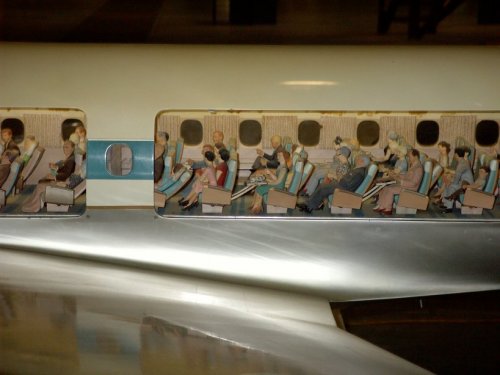

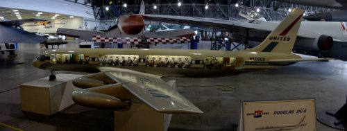

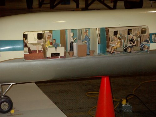

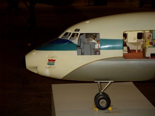

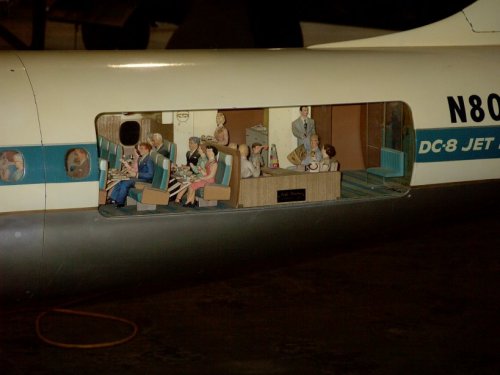

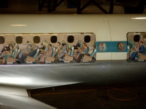

Some closeups:

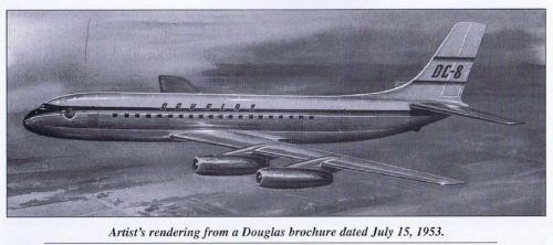

:D
Yep, it was a normal trick, used even in promotional artist views.

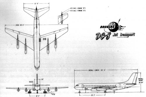

The original 1953 DC-8 had a 35 degrees swept. See attached.
Skybolt said:
:D
Why would they show a diagram with a 35-degree sweep as a "trick" instead of a 30-degree sweep? From what I remember the 30-degree set up worked just fine...
Kendra Lesnick
KJ, the trick I was referring is reducing by 25 per cent the dimensions of passenger in the model to make the cabin look roomier....
Okay, I understand now

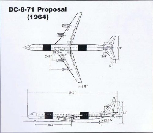

the DC-8 original model and some developments.

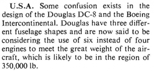

In Air Pictorial 2/1956,
a strange option or considerable choice for Douglas DC-8 to be powered by six engines
instead off four engine,also a three different fuselage shapes,is that a weird Info ?.
