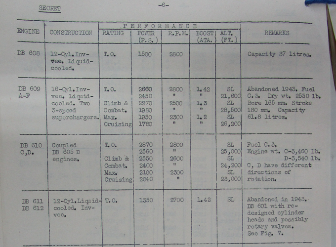

The DB612 was built in reasonable experimental quantities, figures suggest at least ten were at least projected to be delivered. My best guess is that the 611 was another rotary valve idea which probably failed at the first attempt and was scrapped. The 612 was actually run, it just didnt last very long, the discs wore out.
I think the only reason the DB628 double engine wasnt given a double number, was that they stopped at DB632, and the 628
never performed as hoped for, so the double version was almost certainly never even drawn up, let alone built.
Generally these AI2 reports on German prototype engine numbers should be regarded with deep suspicion, however,this is a
post-war document, not wartime guesses from talking to downed pilots or informants. So it is "probably" trustworthy.

Thanks for the reply. And that list has the best information regarding the 608 and 611/ 612.
The 628 was doubled but the doubled motor variant was designated the 620..
My question was why it's doubled version was given a numerically earlier number wheras all other doubled engines were given numbers than came sequentially AFTER their single engined progenitors

Did you not read the last paragraph ?
Dball,
the 1939 DB611 existed alright, a inverted V developing 1180 hp. Specs are equal to the DB612V, differing only in the reduction gearing. The source shown by Calum refers to the DB612A. There was also a DB612B.
The DB 608 was from 1938, 154mm bore, 164mm stroke, 37 litres capacity, developing 1650hp with a weight of 710kg.
