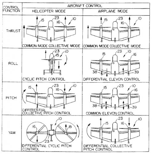

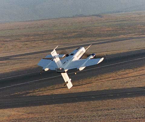

Wouldn't make a configuration with side by side rotors more sense? Think Boeing Heliwing.
Well, Lockheed/Sikorsky's had wing mounted props. They called their configuration "Rotor Blown Wing", IIRC.
I (think) it was a fancy way of saying they were using the aerodynamic surfaces, blown by the props, for control in hover. Remains to be seen if they would get sufficient control authority that way, maybe avoid having to use cyclic on the props? Just speculation on my part.
The Heliwing had collective and cyclic pitch control. Unfortunately, as far as I remember, the prototype didn't survive the first flight. I think the "blown wing" concept is especially troublesome during vertical descent.
I'm aware of a similar air vehicle to the 'Heliwing' and it was only in the [hovering] yaw axis that the 'blown wing' actually worked tolerably well. This particular UAV never troubled transitional flight....
