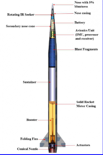

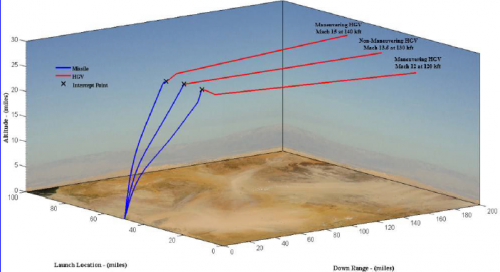

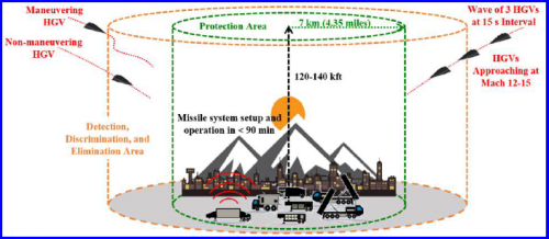

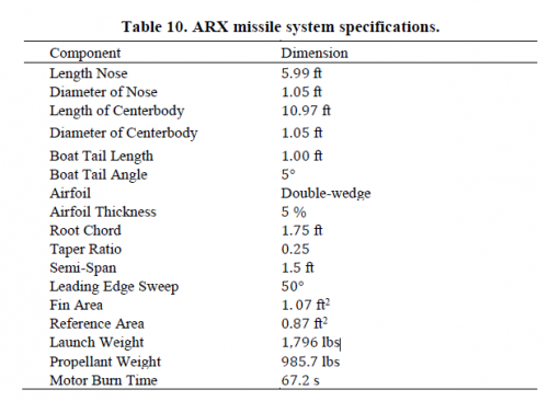

DrRansom said:
It is a graduate student design competition.
The bottom one is. GlideBreaker is something else. (Still wonder if they're looking at THAAD-ER for the role but it seems to have disappeared.)
Lockheed likely is, but DARPA will issue a BAA soon and will be soliciting proposals for investments and demonstrations. I'm sure Lockheed will respond with whatever it has been working on.
The AIAA paper and research was an academic exercise to model something given a set of requirements. It isn't a weapon, but definitely worth a look given they were working within a set of constraints and requirements to mitigate a defined threat.
