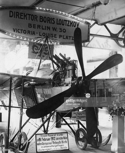

the Daimler-Lutskoy No.1 was a monoplane of 1909,No.2 was a biplane of 1910 and
No.3 was a monoplane of 1913,the designer B.G. Lutskoy was a Russian and Daimler
built his early airplanes,maybe they are L-1,L-2 & L-3 ?.

Boris Lutsky was indeed a Russian but he designed aircraft for VB Shavrov, Rumpler, and Daimler. (He was employed at Daimler-Marienfelde until 1901 when he was hired by Grigory Lessner to help license-build Daimler trucks in Russia.)
Transliterations also get confusing. Луцкой is given as Lutsky, Lutskii, Lutskoi, Lutskoy, or Loutzkoy!
On company names ...
Daimler-Motoren-Gesellschaft Werke - 1910-1919
Daimler-Werke Atkiengesellschaft - 1919-Dec 1926
Leichtflugzeugbau Klemm GmbH - 1927-1938
Klemm Flugzeugbau Halle/Saale GmbH - 1934-1937
Hanns Klemm Flugzeugbau - 1938-Nov 1957
I think the designations L1, L2 and L3 for the Loutzkoy types are doubtful.
Only the first Loutzkoy plane was built by Daimler (even if there is a different opinion), and it was not a plane conceived by Daimler, but designed and ordered by Loutzkoy.
Publications about Loutzkoy are sometimes contradictory (and have always been since the 1910's).
The Russian engineer Boris Lutsky or Lutskoy (Борис Григорьевич Луцкий/Луцкой - both variants are correct) was in the first place occupied with engine and automobile construction, and worked at the end of the 19 th - beginning of the 20th century for a number of German companies, including Argus and Daimler. His German-style name was Boris Loutzkoy (and even Boris von Loutzkoy).
Due to his involvement in Argus and Daimler engines Loutzkoy came also to aviation around 1908-09.
From different sources (see below) I came to the following:
There were two original Loutzkoy types, and a third prepared by Loutzkoy for a flight from Berlin to St. Petersburg.
1. The 1909-10 unsuccesful twin-engined monoplane, called in Russian Геликоплан, an early VTOL-plane conceived by Loutzkoy and built by Daimler. Only Lange says it was built by Aeroplan-Fabrik Max Schuler in Berlin…
2. The 1912 twin-engined Rumpler-Loutzkoy Taube, built by Rumpler. Only Sobolev says Daimler participated in the building ("при участии фирмы Даймлер")...
3. The 1913 single engined Taube reengined by Loutzkoy for the flight to St. Petersburg.
Any additions welcome!

Thank you my dear Tuizentfloot,
but also there is many sources,said that; the Lutsky No.2 was also built Daimler;
http://www.theaerodrome.com/forum/showthread.php?t=41669
As does Sobolev in his article in Kryl'ya Rodiny, and he is a reliable aviation historian. There are too many uncertainties and contradictions about Loutzkoy...
My dear Tuizentfloot,
This Infos came from Milan Javorsky.
I found a website of Milan Javorsky, but it is very general. Indeed it just says that the second Loutzkoy was built by Daimler, as does many others say (and mostly copied from each other).
Many details of Loutzkoy's planes remain unclear, including where they were built. I made the following comparison concerning the builders between the four printed sources I consulted:
1910 Gelikoplan
Shavrov: Daimler
Sobolev: Daimler
Kranzhoff: Daimler
Lange: Schüler
1912 Twin Taube
Shavrov: -
Sobolev: Daimler
Kranzhoff: Rumpler
Lange: Rumpler
1912 St. Petersburg Taube
Shavrov: -
Sobolev: -
Kranzhoff: -
Lange: -
Even Boris Loutzkoy himself has a mysterious side. Working in Germany at the beginning of WW I he was arrested as a citizen of an hostile country. His whereabouts after the war are not well-known. Usually it is said he died in or around 1920 either in Germany or in Russia. But in the twenties and thirties a number of patents were still delivered to him. And his names figures until 1943 in the Berlin address books. After 1943 no more traces of Loutzkoy are found, so probably he died around the end of WW II.
