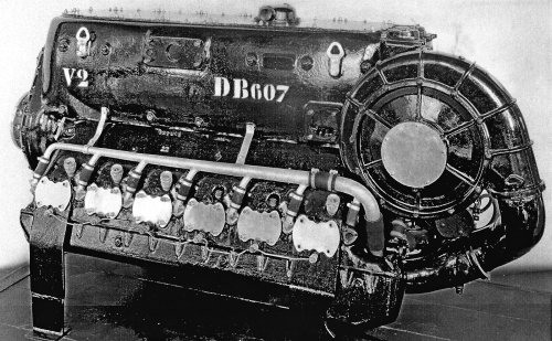

DB 608
Work on this engine were launched in 1938. DB-608 is a further development of the engine DB-601. When the working volume of 36.6 liters the engine developed takeoff power 1210 kW (1650 hp.) At 2800 rev / min. The estimated altitude is equal to 5200 meters. Dry weight was 745 pounds. Engine DB-601 E with a working volume of 33.9 liters at 2700 rev / min developed 990 kW (1350 hp.). Both engines were similar in design 12-cylinder V-engine with water-cooled cylinder heads hanging down. The main difference by developed capacity is the size of the cylinder-piston group. In DB-608 was equal to the diameter of the cylinders 154 mm, 164 mm stroke. The compression ratio was the same as above. At DB-601 was equal to the cylinder diameter of 150 mm and a stroke of 160 mm. DB-608 was successfully tested, but from its production were forced to abandon in favor of DB-601H under the more preferred high-altitude performance. In addition to the replacement of the production of one engine to another invariably would lead to a decrease in production volumes. But not enough to produce the country's aircraft engines and so much hampered the pace of development of the Luftwaffe. It is possible that the creators of the engines of DB-601 was already concluded that the diameter of the cylinder can be increased, and so a few millimeters without significant changes to the entire structure. That a little later and was carried out and thus was obtained DB-605 engine with a displacement of 35.7 liters.

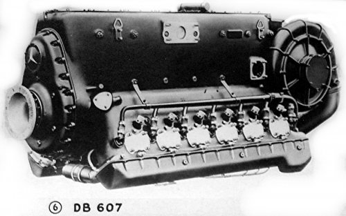

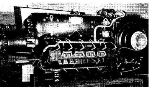

Db-607
DE-607 Diesel was similar in design and size to "603" to 1750 hp. It was abandoned and not enter production
