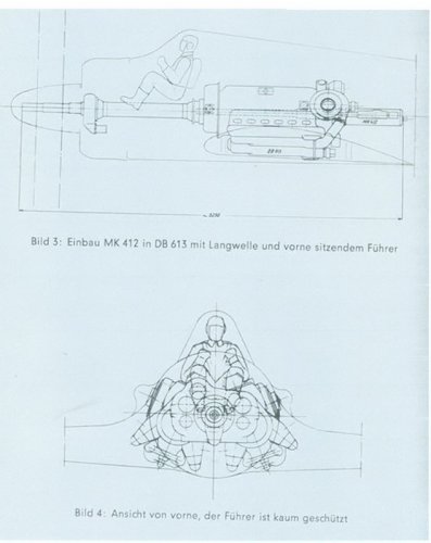

Unknown Daimler Benz? project published on Luftfahrt International Nº5 as
"Daimler Benz 60 Konstruktionsbericht.K21" 21.01.1944

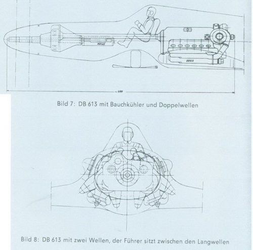

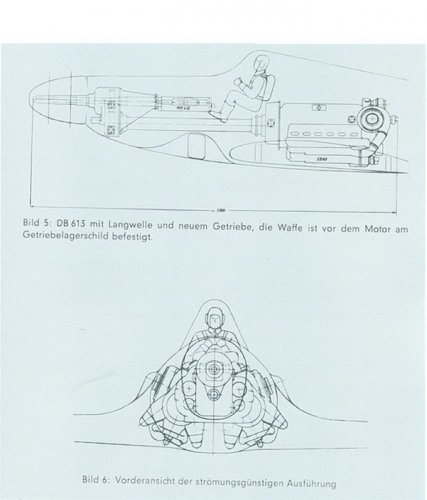

On drawing 001.
Please forgive my ignorance but is that an intake or cooling fan of some sort directly under the pilot on the fuselage underside?
P :)
Flitzer said:
On drawing 001.
P :)
yes the german text labeled it as a cooler
Most likely a heat exchanger for the engine. Not really in the correct position to be a supercharger intercooler.
Given the DB 613 was two coupled DB 603s, and the DB603 could produce up to 3000 hp (albeit in the Porsche T80), that could have been a very fast aircraft.
There is also a similar device on picture 003.
They do look rather streamlined.
