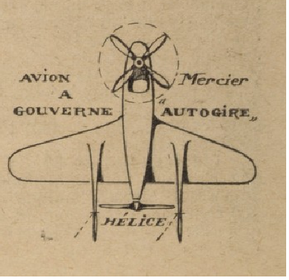

my dear Tophe answer me about that mystery aircraft,which I spoke about it before
in this topic; http://www.secretprojects.co.uk/forum/index.php/topic,5933.150.html
and it was a real aircraft,designed by Cyril Mecier,and called Helican,and as my dear
Tophe said; it was not an Autogyro,but a light airplane having a rotor as a canard
foreplane,it designed in 1936,more details will come.

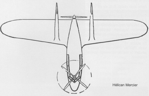

From TU 265,but I don't understand why he called Germain Mercier...
Well, your links (scribd.com and Les Ailes) both give the name M. Germain Mercier as the creator of the Hélican. So, the question becomes: Where did the name 'Cyril' first come from? (AFAIK, Cyril is not a common French spelling - more usually, it'd be Cyrille or Cyrile.)
In the TU article, the mention of Arts et Métiers tells us that our M. Mercier trained as an Ingénieur at what is now Paris Tech. From there, he was involved first with René Couzinet and then Lioré & Olivier. Maybe, but I suspect that the TU editors are confusing their Merciers.
Obviously, there may have been more than one Mercier at LeO. But Lioré et Olivier's chief engineer was Pierre Mercier ... the self-same Pierre Ernest Mercier of cowling acclaim. Another designing/engineering Mercier at LeO - whether a Germain or a Cyril - seems at least improbable.
On the subject of various and sundry Merciers ... I keep seeing referenced to Jean Mercier 'designing' the LeO 45. Wasn't Jean Mercier the hydraulics/undercarriage guy?

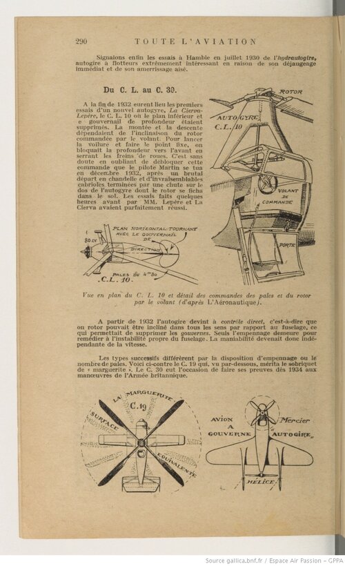

You feel that drawing had a single seat,not two ?.
  • Toute_l'aviation_Ouvrage_honoré_de_[...]Blanc_Edmond_bpt6k9807582h_294.jpeg
