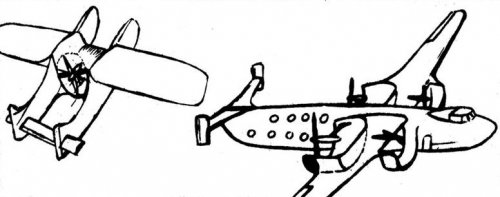

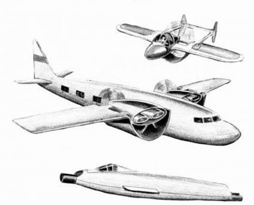

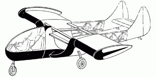

I found those projects for Custer,are those a real designs to him ?.
http://xplanes.free.fr/custer/custer-6.html
Hesham,
I'm not sure if the projects illustrated in "Les avions à aile gouttière de Willard Custer" are real or not. They certainly look plausible (Willard Custer was convinced that most airframes could be advantageously adapted to his Channel Wing concept). The cover shot just looks like the usual PM artist's impression scaled-up from the CCW-1.

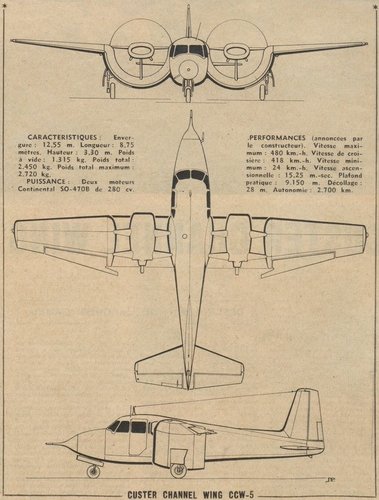

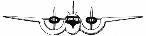

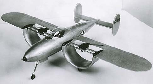

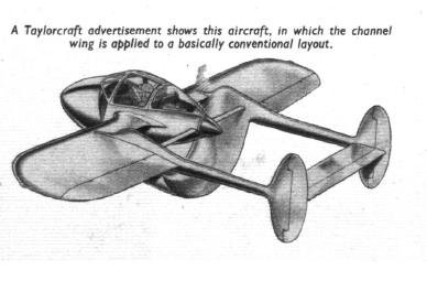

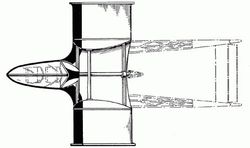

Attached are a few projects that can definitely be attributed to Custer.
BTW, the 1947 project with military stars-and-bars and similar tailplane to the Piper PA-23 'Twin Stinson' which suggests a Baumann connection. Baumann built CCW prototypes and, of course, the CCW-5 fuselage was based on Baumann's own B290 Brigadier prototype.
http://patentroom.com/custer-airplane-design-1955
http://patentroom.com/channel-wing-airplane-1956
http://patentroom.com/custer-channel-wing-airplane-design-1956
http://www.airspacemag.com/history-of-flight/lunch-with-willard.html?c=y&page=1

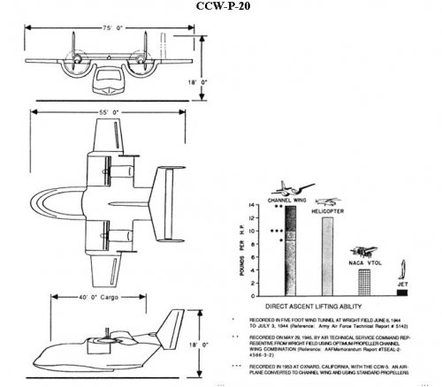

See: http://www.custerchannelwing.com/05_dreams.html for a Custer twin-seat STOL project (bottom of the page). Also on that page, the later but Custer-related 1985-86) P20 Raider and P50 Devastator projects by the Product Development Group (1985-86).
http://www.custerchannelwing.com/05_dreams_p20.html
http://www.custerchannelwing.com/05_dreams_p50.html

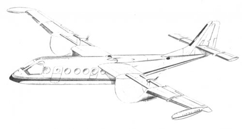

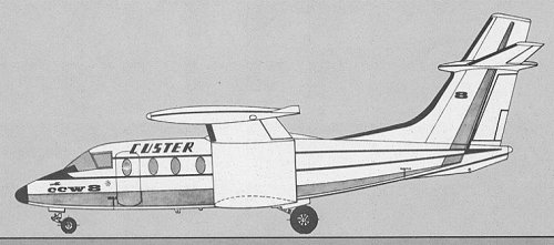

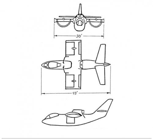

Two other designs by Custer - the CCW-8 and the CCW-12.
SOURCE: Airpower magazine May 1977
Nice! The CCW-12's fuselage-mounted engines with cross shaft drives would neatly get around engine-out imbalances. Weight still seems to be the draw back with Custer designs (I note that the CCW-5 weighed 1500 lbs more than the Baumann B-290 twin pusher that it was derived from).

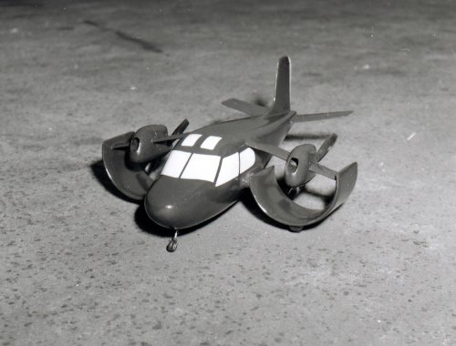

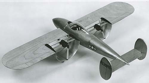

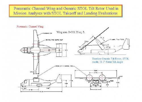

a STOL tilt rotor aircraft use the channel wing.
http://ntrs.nasa.gov/archive/nasa/casi.ntrs.nasa.gov/20050192627_2005195071.pdf

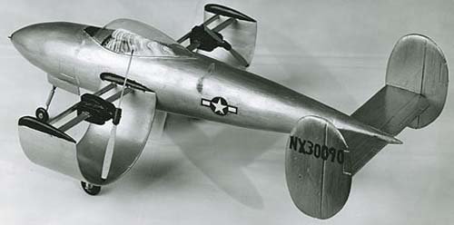

NASA has made available online a series of 26 photographs of the earlier CCW-2 Channel Wing model, as tested in 1952:
Here is some historical background from Wikipedia:
CCW-2

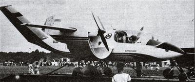

This was an evolution of the CCW-1 as a single-seat test bed and used an adapted uncovered fuselage of a Taylorcraft BC-12 light aircraft, replacing the single engine with two pusher engines fitted each side of the fuselage and placed within the wing channels.[3] The sole example N1375V first flew on 3 July 1948. It was flown for about 100 hours of testing with take-off and landing being made within 45-65 ft. Despite the claim of "flying better than a conventional aircraft" it was calculated that a stock Piper Cub was more efficient, lifting 18 lbs/h.p. versus the CCW-2s 11 lbs/h.p.

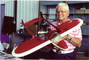

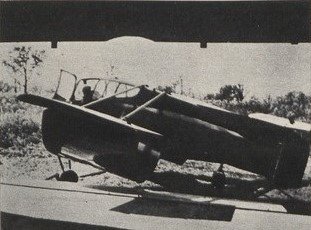

Greetings All -
It appears that at some point Willard Custer spent time at Parks Air College here in St. Louis where I live. I have not been able to determine if he was a visiting speaker or was possibly a teacher here but the Parks Air College archives had these two images of him and a model of his concept. Photos are from the St. Louis University/Parks Air College Collection.
Enjoy the Day! Mark

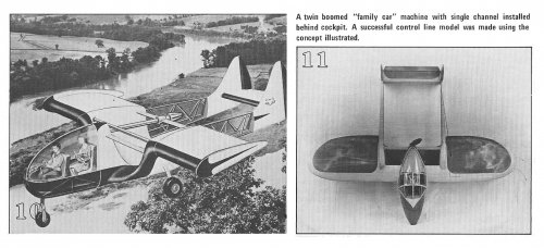

Apophenia said:
hesham said:
Both designs seem to have been related, as seen below in this extract from the same Airpower magazine of May 1977 previously mentioned by Boxkite:

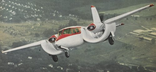

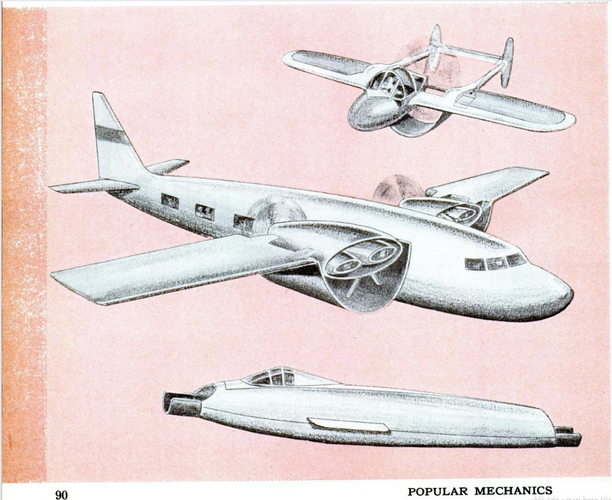

Excellent article in Issue 16 of The Aviation Historian on the Custer Channel Wing designs and proposals. As well as many photos and a diagram of how the wing worked, there are also 3 views of the CCW-1 and CCW5 designs. Pages 106-119 refer, plus a colour image on the rear cover. Also a bit about the NASA Langley work on the concept from the mid-nineties.
Popular Mechanics 0ctuber 1964 link
https://books.google.co.ve/books?id=QOMDAAAAMBAJ&printsec=frontcover&hl=es&source=gbs_ge_summary_r&cad=0#v=onepage&q&f=false

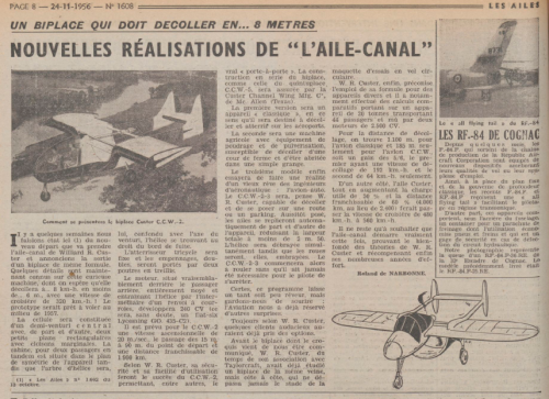

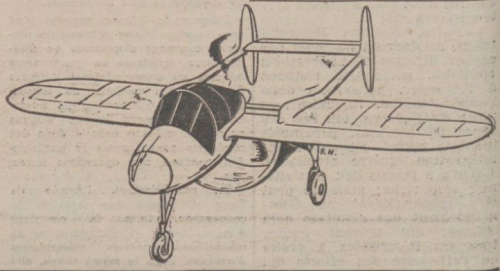

From Ailes 11/1956.
