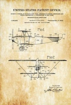

I know it was only a patent,but I feel it was a real aircraft or Project,it was a sesquiplane,can anyone
help me and ID it ?.
https://www.pinterest.com/pin/615867317766946734/

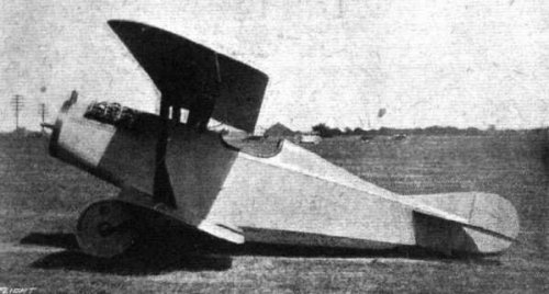

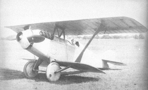

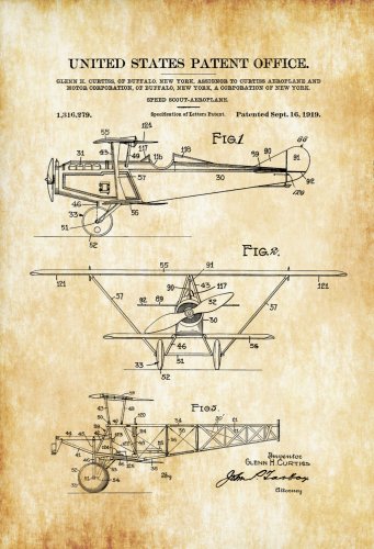

I think this may have been an earlier version of the Speed Scout patent or a reconnaissance version of the same patent. The Speed Scout S-1 and S-2 were built and flown around 1917. Patents filed in 1916 and awarded in 1919. They do look similar to the patents.S-1 was an unarmed variant of S-2.

This is from patent US1323842, applied for in 1916, which was for a system of low-drag strut bracing without wires. Dynoman is correct that the system was trialled on the S-2

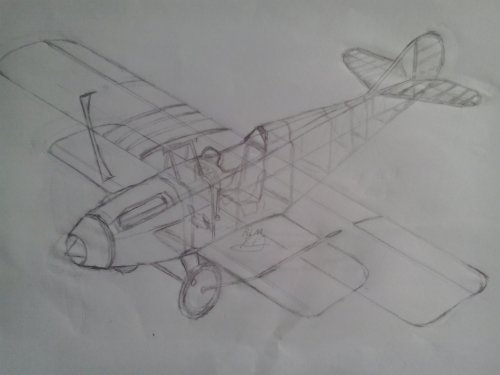

Next cutaway Curtiss Wireless in progress...!
The promised:

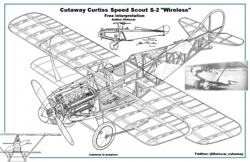

Cutaway Curstiss Speed Scout S-2 "Wireless", small biplane of the firm created in an attempt to build a small plane that was ahead of its time, its structure left aside the use of the cables from there the name "Wireless", propelled by a V-8 engine of the same company, there are very few data available only some blurred photographs and drawings of the patent application introduced by the company Curtiss, work in progress, author Motocar

From here to this almost definitive and modest job ...! And last retouch "viewed 12 times"
