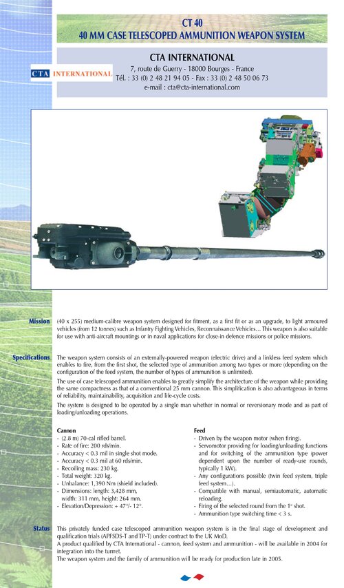

How 's the real accuarcy of 40mm CT cannon?
i mean ,not the data on those pdf, as we all know the 2a42 cannon is famous for its terrible accuracy but the test data of it is only a lit bit difference between the m242 bushmaster
the 40mm CT cannon seems have the same problem but i m not sure my opoion is correct,accroding to the CTA's pdf the accuracy of 40mm CT cannon is :
<0.3 mil both in single shot mod & 60rds/min
But in the teaser of french EBRC jaguar,the performance of 40mm CT is really terrible: 5 shots 3 miss, which is much more awful than the accuracy claimed in the pdf,almost as terrible as 2a42
the link of teaser is here: 法国40毫米埋头弹精度belike
i really wonder why the depression of 40 CT cannon is terrible like that? Its the problem of the jaguar itself or that is the the real accuracy of CT cannon ?

question solved,those French didnt active the stablizer,no wonder the EBRC shaked so bad
