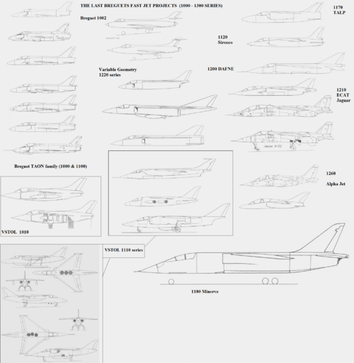

Working from the old Jean Cuny book "les avions Breguets" I have done a "patchwork" picture of the company few last fast jets projects. From Br.1000 Taon to Br.1260... Alphajet.
They were the 1000, 1010, 1070, 1120, 1200, 1210, 1220 and 1260. They encompass transonic fighters, VSTOL, bomber, VG types, a trainer and... Jaguar obviously.
There it is... a tapestry of Breguets.
- 1000, 1002 and 1100 are transonic LWF
- 1010 and 1110 are a whole bunch of VSTOL including a French Harrier
- 1120 is the Sirocco ( = naval Mirage F1 clone, ten years before the F1).
- 1170 was very much a F6D Missileer (slow missile truck for fleet defense)
- 1180 was a "Super Mirage IV"
- 1200 DAFNE was essentially a French Spey Phantom for supersonic fleet defense, fixed wing.
- 1210 became ECAT, then Jaguar
- 1220 are Breguet VG types (Breguet MiG-23 and Mirage G and Tornado and F-111)
- 1260 became the Alpha Jet after Dassault took over in 1969 - last Breguet ever, still alive !
My favorite are the naval fighters: 1120, 1170, 1200, 1220.
They are, respectively: Breguet Super Tiger, Breguet F6D, Breguet Phantom and Breguet F-111B or F-14.

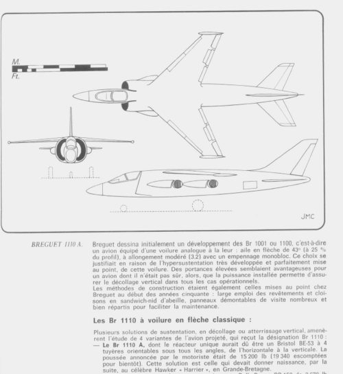

I have no idea how it relates to P.1127 early studies, pre-1960. Just that Breguet 1100 series were 1957-58.
