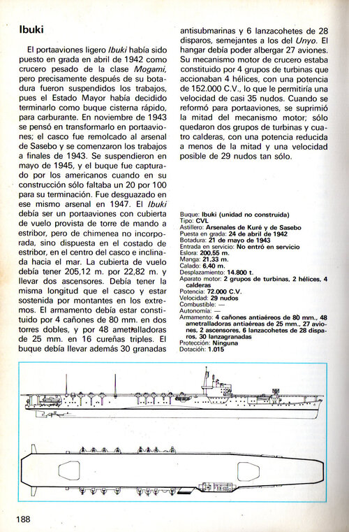

My little contribution:
Never finished CV Ibuki, built over the hull of the never finished light cruiser of the same name. I get the image from the book Portaaviones de todo el mundo, from Gino Galuppini. Editorial Espasa-Calpe S.A. Madrid 1984

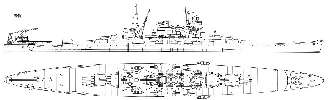

By the way here are the Design X cruisers aka the Japane Courageous:
And the revised design:
Chichibu?
The cruiser with a 305mm main gun cannot be sure

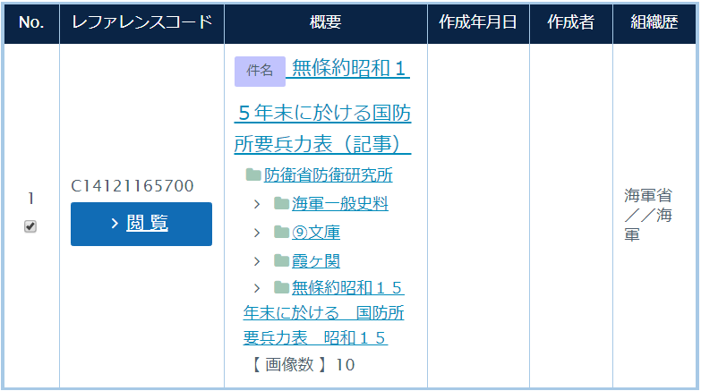

Speaking of cruiser with large calibre guns, there was a plan in 1934 to mount 10in guns on Mogami class https://www.jacar.archives.go.jp/das/image/C14121167000
Are you sure that these table shows proposals? It looks to me as ship construction proposals or even wargame to counter the USN.
On the 2nd page the rightest most column shows USN BB names:
West Virginia
Colorado
Massachusetts
California
Tennessee
Idaho
New Mexico
Nevada
Arizona
the second row on the 3rd page contains rest of the USN BB's in 1937:
Pennsylvania
Oklahoma
Maryland
New York
Texas
Arkansas
missing from the list:
Utah, Wyoming, Mississippi
8x Unknown Battleships
4x Fast large Battleships, Note there were no 65.000ton (aka Yamato) 34knot / 63km/h BB design of the IJN!
2x 41.600tons likely the Nagatos
The Fusos and Ises seems to be missing.
The cruiser part is also weird.
4x 18.000ton 36knot cruisers
2x 15.600ton 36knot cruisers
2-2 other cruisers? Kongos maybe?
8x 10.000ton 36knot cruisers (Myoko and Takao classes)
4x 7.100ton 36knot cruisers (Furutaka and Aoba classes)
6x 8.510ton 36knot cruisers (Mogami and Tone classes)
87??? 5.500ton 36knot cruisers (There were 14 such cruisers: 5x Kuma, 6x Nagara, 3x Sendai)
Where are the two Tenryus and the Yubari?
32x 2.000ton 36knot destroyers (There were 10x Fubuki, 10x Ayanami, 4x Akatsuki 10x Asashio (5x Kageros were laid down in 1937))
48x 1.400ton 36knot destroyers (15x Minekaze, 9x Kamikaze, 10x Mutsuki, 4x Hatsuharu, 10x 1.700ton Shiratsuyu)
I need a Japanese-English translator to decode this table!

from what I understand, it looks like a table of required military forces at the end of 1940, after the collapse of naval treaty.
I made some translated version but it might be wrong to some extent
8x Battleships (戦艦) - Nagato class, Fuso class, Ise class, and Hiei + one more Kongo class?
4x Fast Battleships (高速戦艦) - 2x New fast battleships (新高戦, aka early concept of Yamato class), 2x Kongo class
4x Middle size Aircraft Carrier A (中空母 甲) - 18000t class (early concept of Shokaku class)
2x Middle size Aircraft Carrier B (中空母 乙) - Soryu, Hiryu
2x Large Aircraft Carrier (旧大空母) - Akagi, Kaga
2x Small Aircraft Carrier (小空母) - Hosho, Ryujo
8x Large Heavy Cruisers (大巡) - 10000t, Myoko class and Takao class
4x Middle size Heavy Cruisers (中巡) - 7100t, Furutaka class and Aoba class
4x Middle size Heavy Cruisers, modified (中巡改) - 8510t, Mogami class and Tone class (10in gun conversion was considered)
8x 5500t class cruisers (乙巡) as a flotilla leader + 4x 5500t class????
32x Large Destroyers (大駆) - DDs after Hatsuharu class?
48x First class Destroyers (一駆) - Fubuki class, Ayanami class, Akatsuki class + old DDs + 8 unfinished DDs?
etc.

Part of my design number collection came from this blog entry:
Which mentions two other design numbers I do not know about: C-40 and C-43.
This C-43 was apparently not the Yuzuru Hiraga C-43 design as he too mentions that design.
C-40 was apparently to be part of the Maru 4 Programme which at first included but later left out 2x 13.000ton heavy cruisers (Improved Tone type) (according to the Japanese Wiki) so I think this would be the Tone-Kai type cruiser
C-43 was written as 計画のみ - Plan Only. Based on the design dates near it (C-42 - Oyodo of 1939 and C-44 - Agano-Kai of 1940) this design could be from around 1940 and might be the mysterious Heavy Cruiser that was planned around this time and of drawing exists from a news article showing a 4x3 20cm armed cruiser with aft torpedo tubes and catapults.

also, I've never heard of the cruiser design with 4x3 20cm and aft torps (could you show me the drawing?)
The first C-41-43 was from the Hiraga Archive and likely Hiraga's own designation. The later C-43 was the one I'm talking about.
That cruiser with 4x3 turrets was from this article:
and which already made into the WoWs as Zao (Originally Senjo or Unzen).
Officially we only know that 20cm cruisers were planned for the 1940 or 41 programmes. Ive not yet found any other info about this cruiser. Ive heard a rumor that Wargaming found evidence or even documents on them but I'm very skeptic about this.
The first C-41-43 was from the Hiraga Archive and likely Hiragas own designation. The later C-43 was the one I'm talking about.
ah, that one is totally fake (you can see the word "本書想定" on the top left, that means everything about this design is fabricated by the magazine)
Even without the note that it is fictitious the floatplanes and catapults at the stern make me doubtful. As far as I know scouting for the fleet was an important role for the Japanese cruisers which is why they tended to have two catapults and space for at least three floatplanes amidship. Grouping all of the torpedoes at the stern also seems like it would make a vulnerable to a hit devastating the stern and crippling the steering of the ship.
Indeed. Since it's emergence on the net like 10-15 years ago the number of issues were:
- The torpedo tubes are way too aft there is very little space for them and basically no space to reload the aftermost ones.
- USN style aft and single catapult for one floatplane (Even the Aganos carried two)
- Mainmast with crane for only boat transport. IJN used a single mast for both aircraft and boat handling, otherwise the boats lowered by davits. (Though there were a few Myoko preliminaries showing small cranes on the turrets for aircraft handling due to forward oriented mainmast)
- Rather "thick" hull eg the nose is quite wide not reminiscent of the fine lines of the IJN cruiser well known of.
- Turreted 10cm AA guns, well they sure are well protected but it would be more likely to use Oyodo style shielded mounts.
