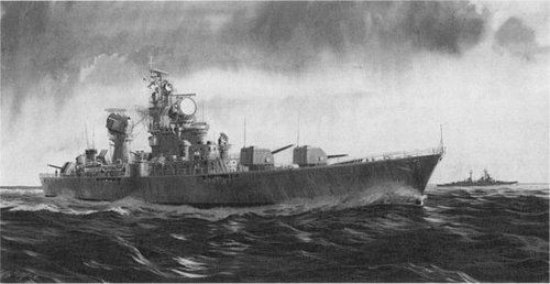

This long out of print had a beautiful cover artwork on this theme.

Just looking at this image the potential upgrade path could include an RAN configuration Ikara replacing the Limbo, Tartar (system including directors and associated equipment) replacing the 5" in B position and one of the 984s, helicopter facilities replacing the aft 5". Not a minor effort at all but achievable when looking at similar modernisations conducted by other nations fitting Tartar to existing or new build ships.
Does anyone know anything about the variants with twin instead of single 5"mounts? Were they distinct studies or did they simply swap out the fully automatic singles for simpler twins?
Note the two big Type 984 radar sets
2 logical reasonsNote the two big Type 984 radar sets
Maybe a stupid question, but what do you need TWO Type 984s for in a ship of this size?
