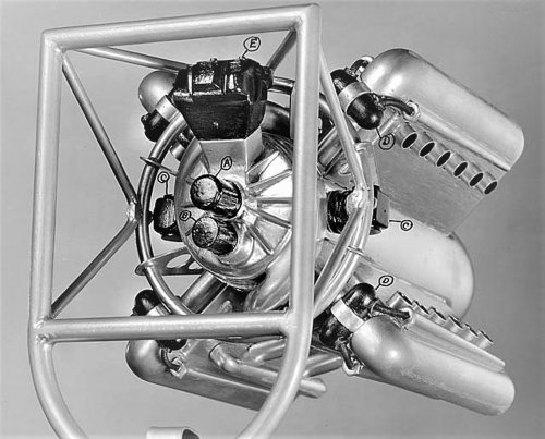

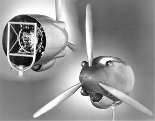

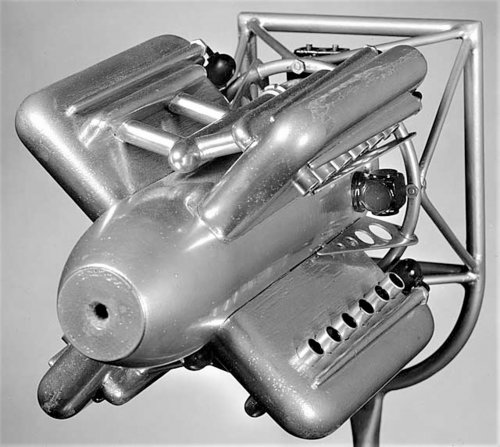

On May12th 1942 a report was submitted to Ray Olson Jr of the Navy Department proposing an all new 24 cylinder aircraft engine, designed by Taylor Engine of California. This would be a fabricated block engine using ideas developed by Daimler and Mercedes-Benz in the early years of the automobile as well as the 27 liter Liberty V-12 aircraft engine during WW-1.HP estimated from the 950-1050lb package:
Un-Supercharged 1000 HP
Supercharged 32 In.* 1,250 HP
Supercharged 39 In.* 1,600 HP
Supercharged 48 In.* 2,000 HP
*Manifold pressure in inches of mercury(hg).
The overall size with tapered nose for the prop and the rear accessory drive assembly was 76 inches and 45.5 inches in diameter. It was interesting to look at the drawings and see if the front nose and rear assembly was removed, the engine was almost a perfect cube and would have fit in a 36 X 35 inch box.
