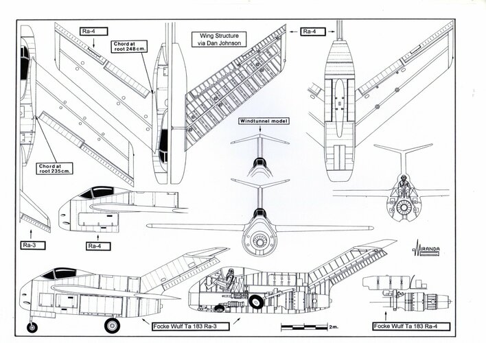

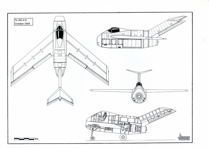

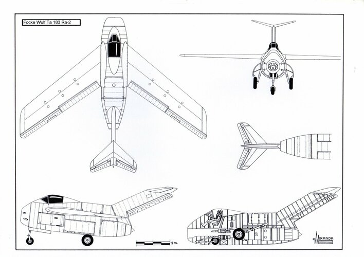

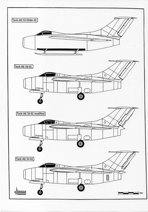

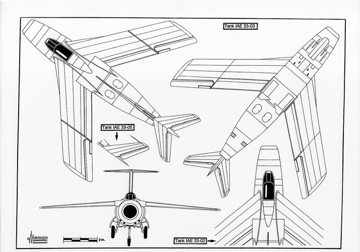

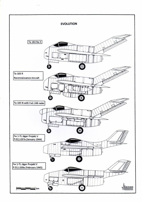

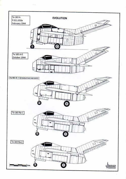

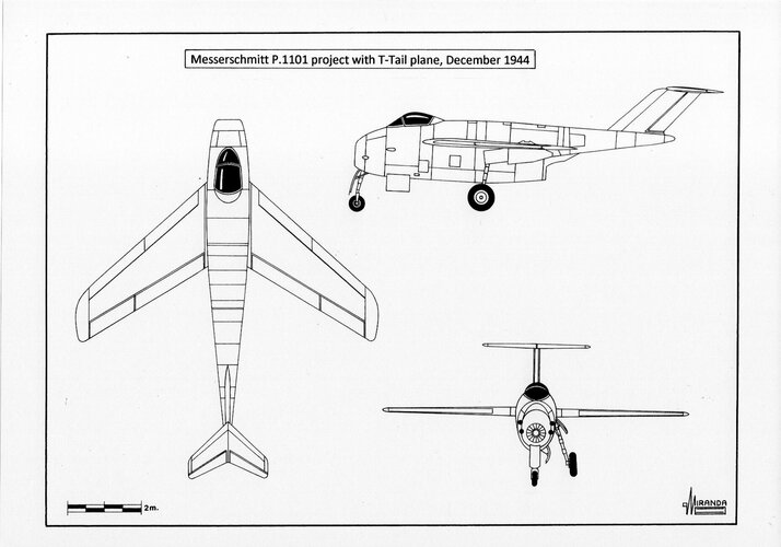

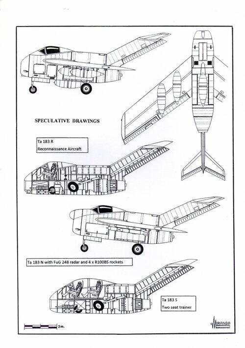

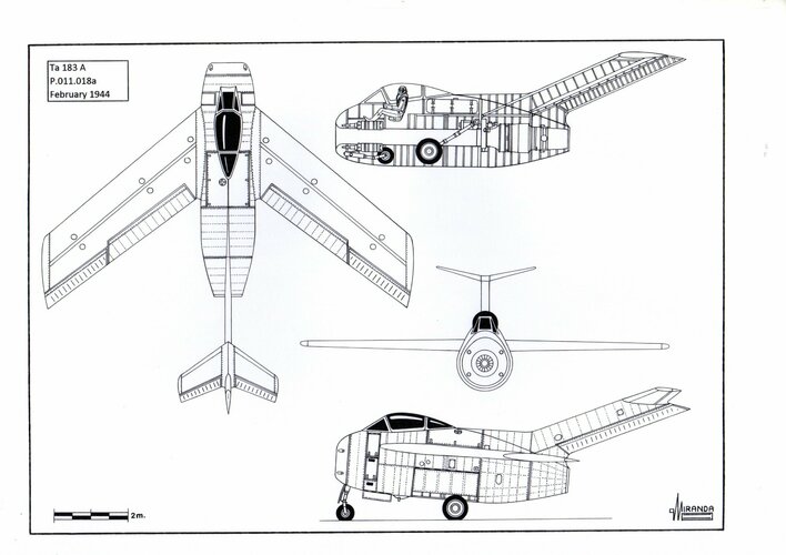

I heard rumour that TsAGI analysis found that the Ta-183 Design II would have shed its tail (although the IAe 33 Pulqui II seems to have eventually managed to make a somewhat similar t-tail work). What other issues did late war WWII designs have?

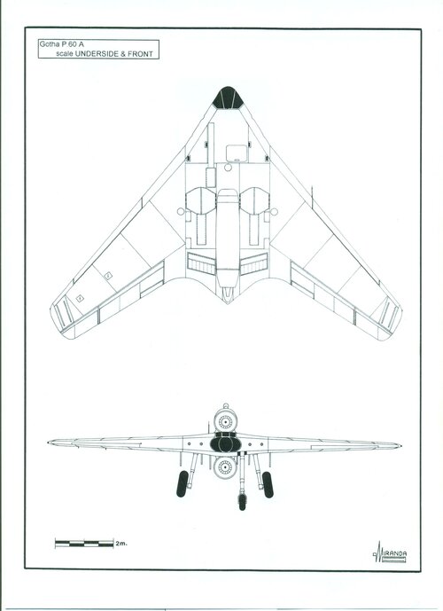

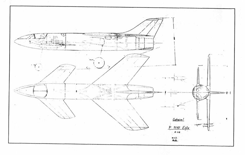

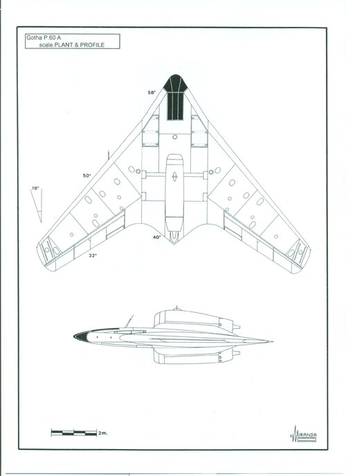

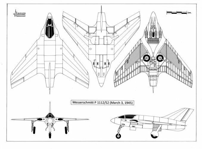

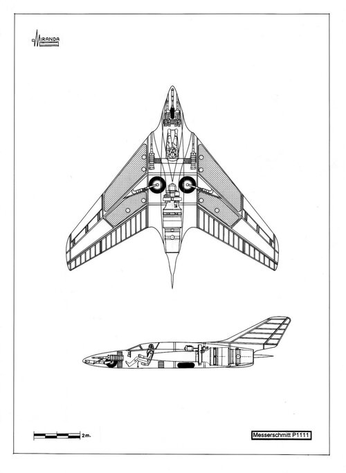

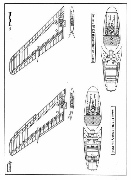

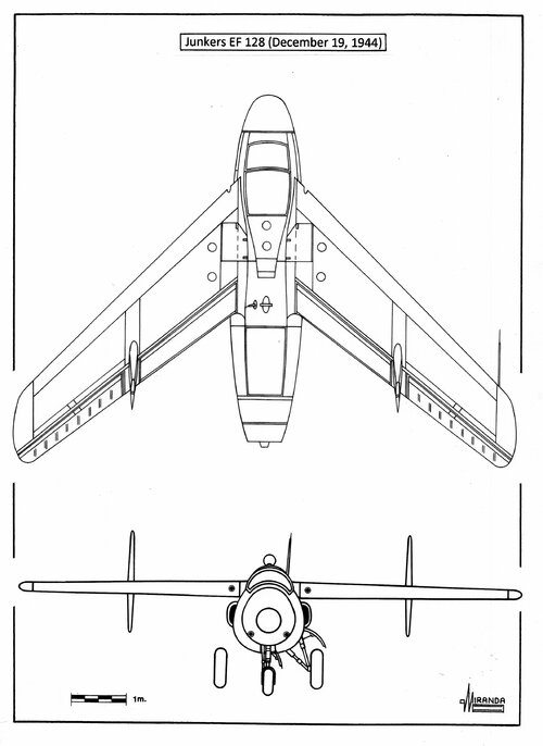

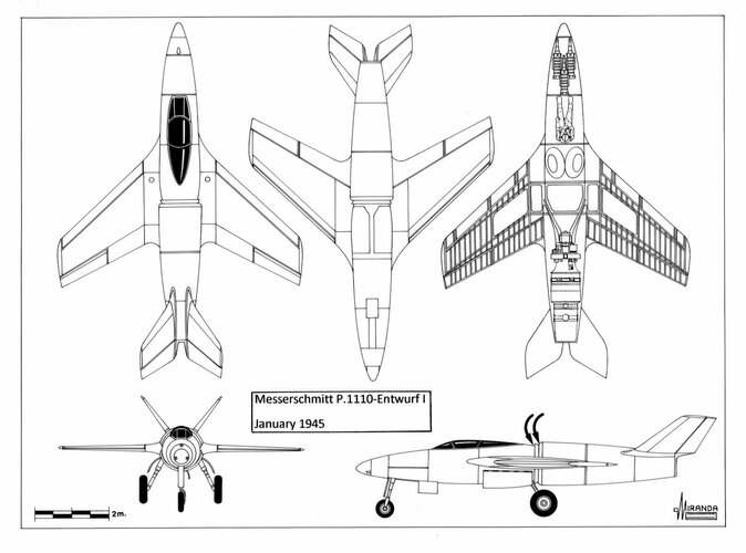

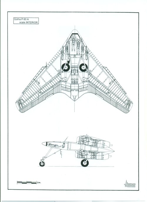

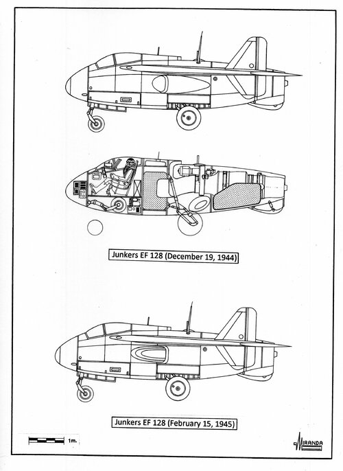

Ju EF 128 intakes might have had a lot of duct losses, the Gotha P.60 upper intake might have had issues with air-pressure fluctuations with variations in angle-of-attack, the later Messerschmidt P.1112 design intakes seem even more dubious... would any of these have worked adequately? It is interesting to think about.
With more than 75 years of hindsight - what other ideas can we rule out? Which aircraft might have gotten off the ground?

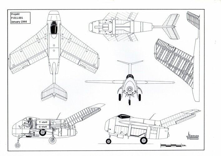

Well, we had a discussion on that on a German forum, and it turned out that in July of 1944, the Jägerstab had all projects stopped that were not part of the official program. So any engineer working on a project not based on a Jägerstab or later Rüstungsstab requirement wouldn't have gained any protection from that ...

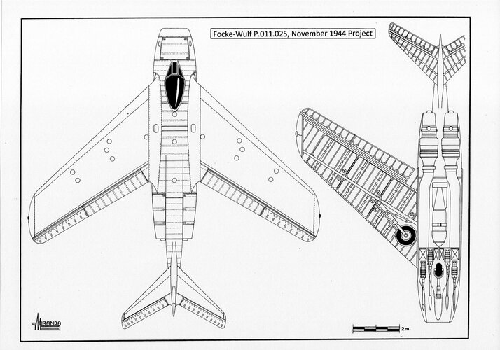

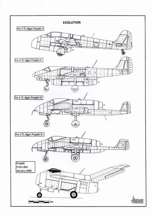

Here's an order to Blohm & Voss, requesting the development of a jet fighter with a He S 011 engine, based on 1) Blohm & Voss' Volkjäger design, 2) based on the designs Blohm & Voss had previously submitted for a high-performance piston-engined fighter, in the configuration of a flying wing with wingtip stabilizers:
Regards,
Henning (HoHun)

I think it's telling that the postwar aircraft that had most input from the German (or ex German) designers don't really seem to have been that successful, even when paired with more powerful and reliable engines. E.g. Pulqui II, XF-92
