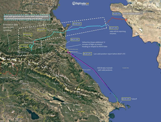

The Embraer 190 aircraft took off from the Azerbaijani capital Baku on Wednesday morning. It was due to fly to Grozny in Chechnya but it was diverted because of fog, the airline said.
A surviving passenger told Russian TV he believed the pilot had tried twice to land in dense fog over Grozny before "the third time, something exploded... some of the aircraft skin had blown out".
The plane was redirected to Aktau airport, some 450km (280 miles) to the east. Footage shows the aircraft heading towards the ground at high speed 3km (1.9 miles) short of the runway, before bursting into flames as it lands.

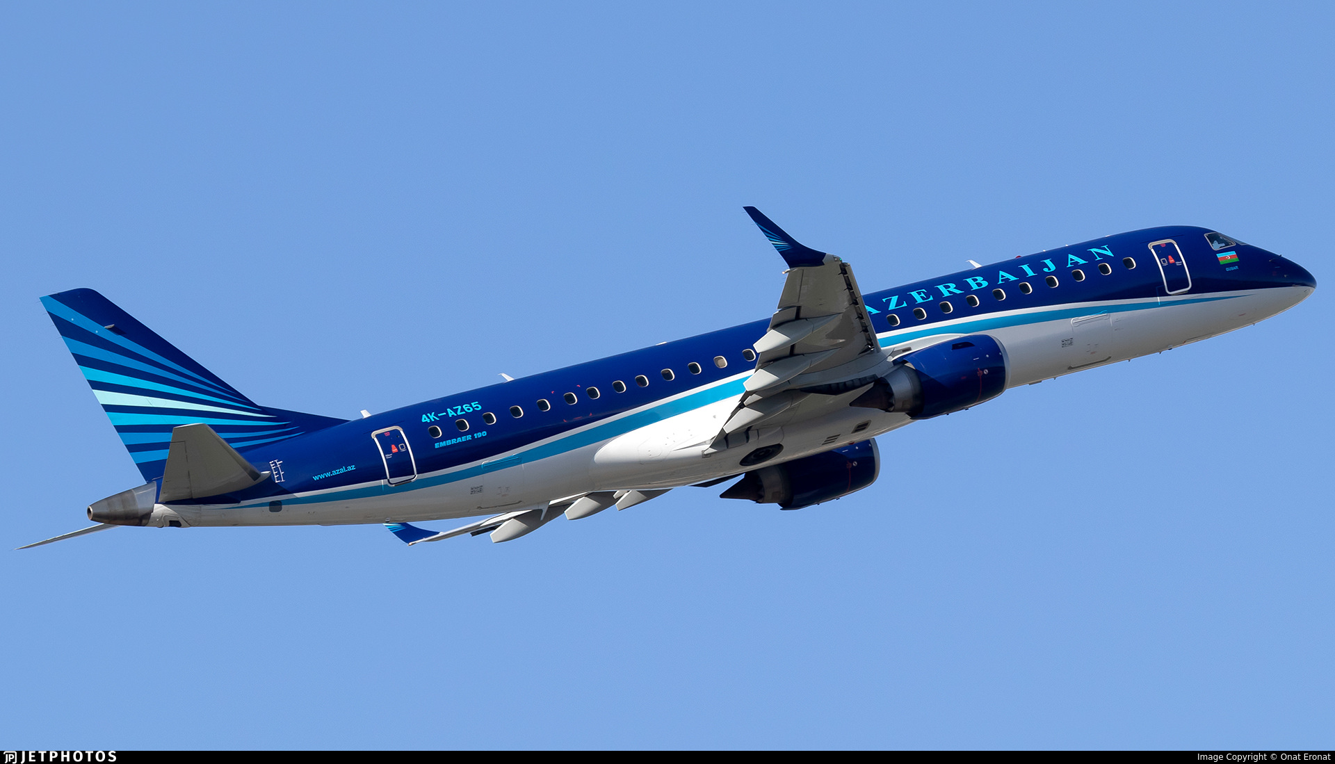

Aircraft serial was 4K-AZ65, built in 2013 with 9949 total landings and 15 257 hours flown.
