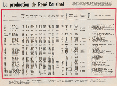

RC.1000 Elan was a side-by-side two seat low-wing touring
monoplane Project,powered by single engine,Project of 1934
RC.2000 was a two-three seat mid-wing observation and recce
light attack monoplane Project,intended for A.3 or BR.3 Program
of 1934

here is the list for Air-Couzinet,it was taken prefix "AC",but turned to use prefix "RC" later;
AC.01 was postal transport low-wing monoplane Project,powered
by two engines,led to develop the AC.10,1936/37
AC.10 was a postal transport low-wing monoplane,powered by two
720 hp Hispano 9V engines,1937
AC.10 B4 was a four-seat heavy bomber Project,a version of AC.10,
but powered by four 720 hp Hispano 9V engines,1937
AC.11 was a longer fuselage version of AC.10,powered by two 140 hp Renault Pei engines,1938
AC.12 ------?
AC.13 was a three engined version of AC.10,Project of 1938
AC.18 was a large flying boat Project,powered by eight engines,1938
AC.20 was a four-seat low-wing heavy day bomber monoplane Project,powered by four 720 hp Hispano 12 Xirs engines,1939

I add four speculative designations until get confirm,
they are AC.140,AC.150,AC.160 & AC.170,the source is;
