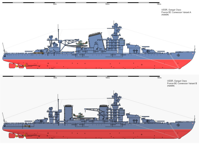

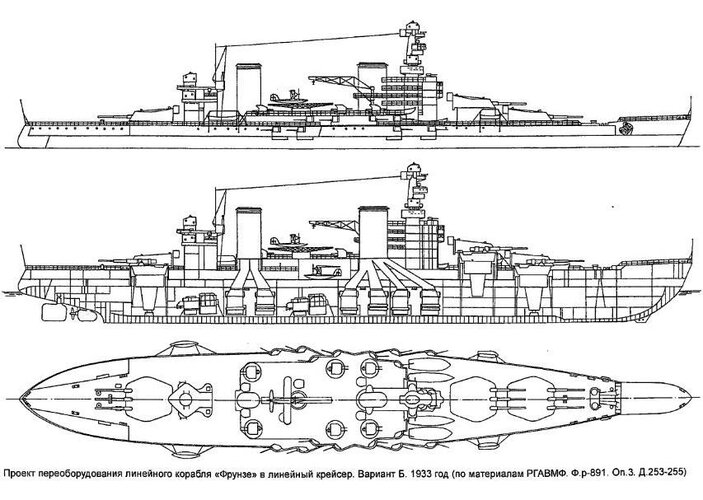

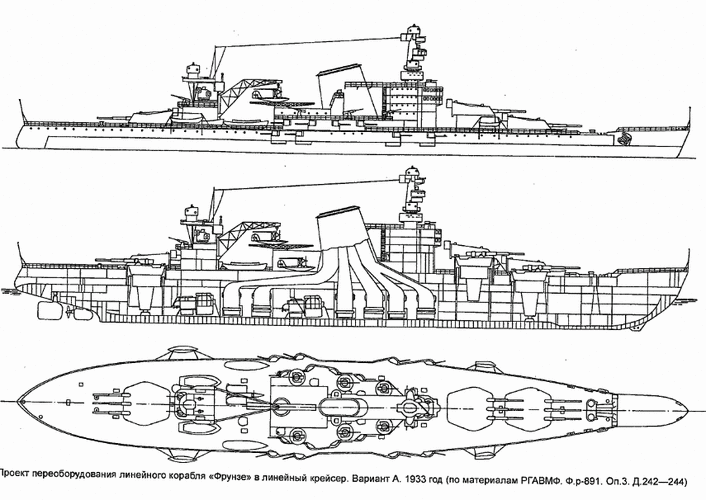

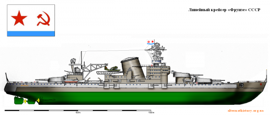

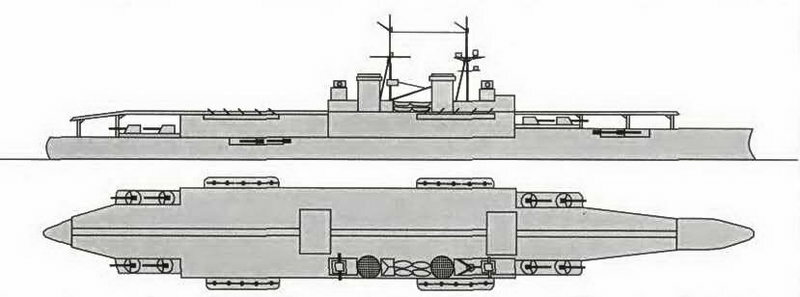

Rene Greger published in Warship 1990 a small note dealing with the Russian battleship Poltava later renamed Frunze and the several proposals to convert her. He mentioned a conversion into a battle cruiser (confirmed by McLaughlin) and published 1 sketch (McLaughlin 2) and wrote that there were sketches of her proposed conversion into an aircraft carrier scheduled around 1925. McLaughlin confirmed this idea but Greger neither McLaughlin published such a sketch. Can anyone supply such sketch(es). Secondly Greger wrote that after 1926 other conversion schemes were proposed ranging from a floating battery to a fast battlecruiser; see for the latter above. Anyone familiar with this proposals? Breyer doesnt'supply more details.
Yep, these are the two known projects, but even in her "Battlecruiser" proposal the expected speed was 50km/h or 27knots in par with the second generation battlecruisers (Lion, Queen Mary) but still better then the original 43/44km/h or 23-24knots.
Note that the expected installed engine power was 120.000shp while the original had 42.000shp but after the 1928 refit, 61.000shp. Which shows the difficulty of increasing the speed of WW1 or in this case pre-WW1 era battleships to WW2 era standards.
There was also a proposal to convert the Frunze/Poltava into an aircraft carrier, which also foundered due to the Red Army shooting down funding for it.
Some Russian guy on the "Little-known unrealized projects" section of this blog provides a lot of details on the reconstruction, with source stated as "Gangut magazine, No. 20"

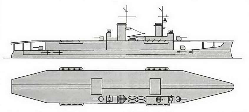

As I wrote above Rene Greger (Warship 1990) also referred to a conversion into an aircraft carrier under the 1925-1931 programme just like the battlecruiser Ismail to be done in 1925. The Poltava would carry 50, the Ismail 90 aircraft. Greger mentioned that according to sketches the Poltava was completely flush decked with no Island just like the first Japanese carriers. It seems that Greger saw some sketches, it's a pity he don't give any sources except for an article published in Sudostroenic. The Red fleet was a speciaility of him.
Jurgen Rowehwer/Mikhail S. Monakov in Stalin's oceanic-going fleet, page 16 wrote that Zof's deputy assistant V.I. Bzhezinskij presenten on 4 June 1925 the 1925-1931 programme asking for the conversion. Reference to J.N. Westwood, Russian Naval Construction 1905-1941, London, Macmillan , 1994 p. 138-9.
On the internet a certain Tomasso Balconi (https://www.shapeways.com/product/SK863C42Y/1-700-carrier-frunze-poltava-flight-deck-front) offered a model of her as aircraft carrier for sale. I presume he used drawings as base for this model.

You can find them here:
Neither the Frunze nor the Ismail would be flush decked.
