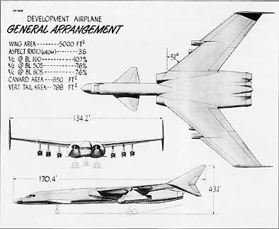

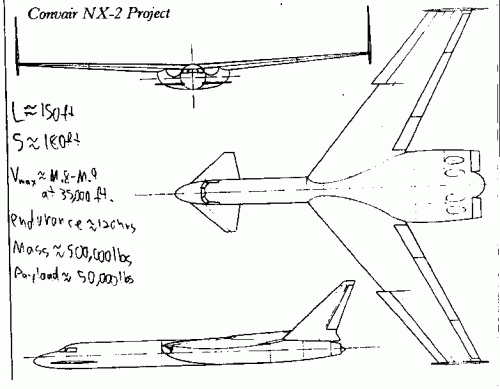

Ugh. That's *horrible.* FOr two reasons:
1: The drawings aren't that accurate
2) The dimensions are pure guresswork. My *own* guesswork, and my own handwriting. I scanned those drawings in... probably 1993 or so.
All wrong....

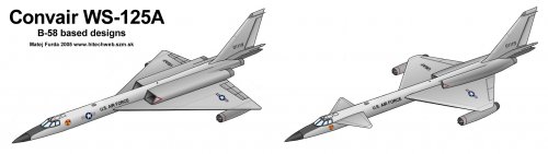

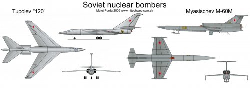

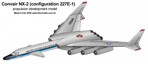

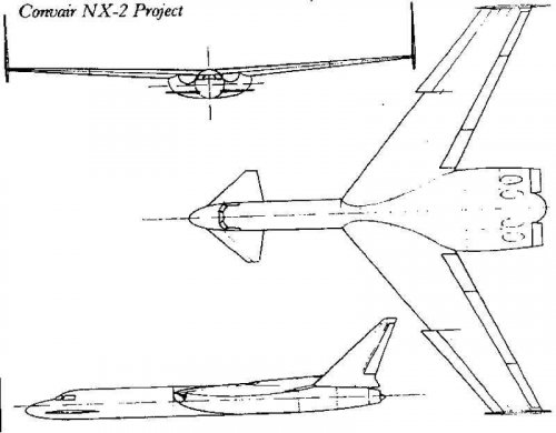

Anyway, here (maybe, if I do this right) is a better three-view:
And some my drawings that I used in an article...

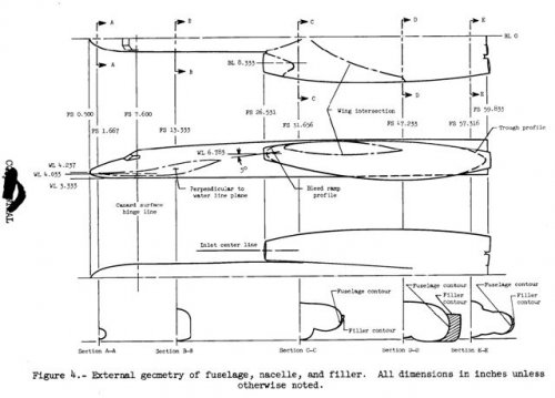

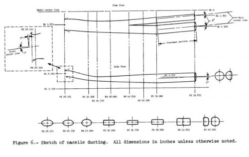

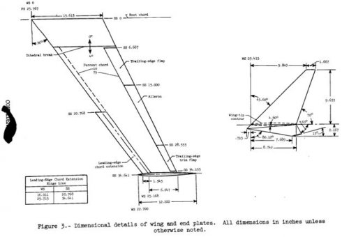

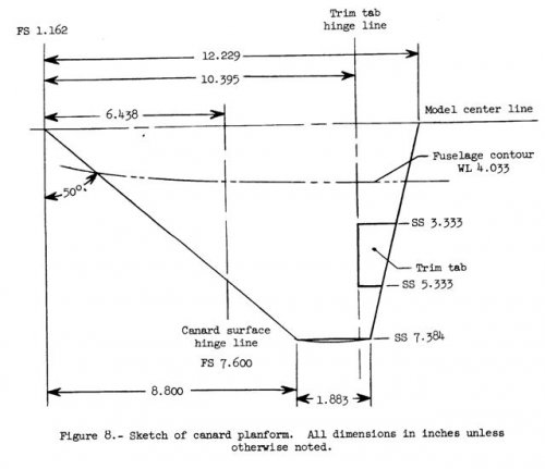

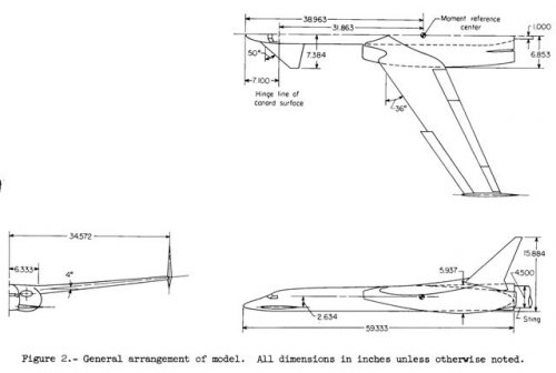

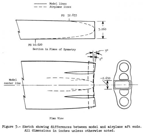

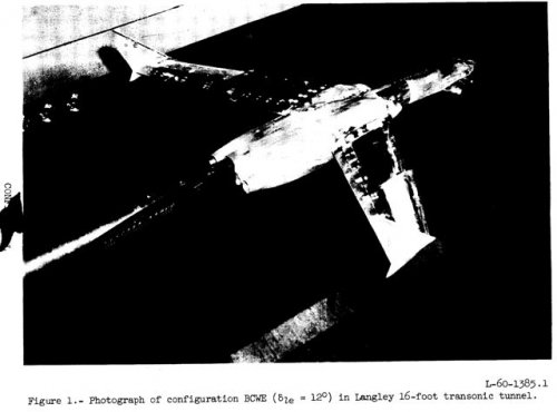

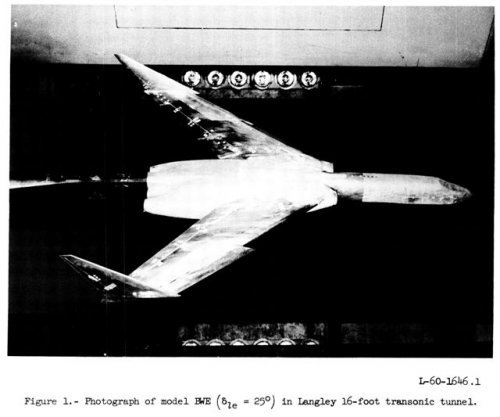

1/30 scale NX-2 model stuff found at NTRS
TECHNICAL MEMORANDUM X-669
LONGITUDINAL AERODYNAMIC CHARACTERISTICS OF A 1/30-SCALE
SUBSONIC CANARD-AIRPLANE MODEL HAVING A WING WITH
AN ASPECT RATIO OF 3.6 AT MACH NUMBERS FROM 0.30 TO 0.98
By William B. Igoe, Richard J. Re, and Francis J. Capone
Langley Research Center
Langley Station, Hampton, Va.

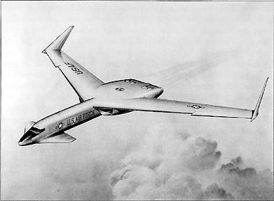

Great, Gregory, but remember the NASA Rule of Overscan: please cite the report number! ;D
hesham said:

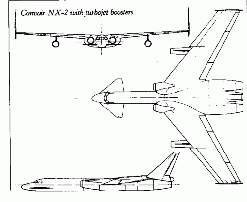

Early concept for the Convair NX-2.
No, it's not. It's a "Flight Magazine" artists impression of what the NX-2 looked like, based on a text description, not drawings.
And those engines (specifically, their inlets) are located in just about the worst possible place.

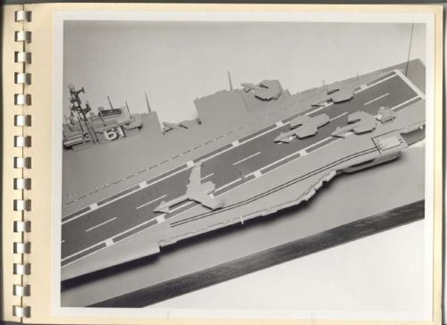

Convair NX-2 aircraft carrier compatibility studies included this spotting model diorama. Note NX-2 multi-segment wing folding arrangement and trolley for convenient, on-deck powerplant exchanges. Interestingly, the aircraft carrier itself (USS Ranger, CV-61) is not nuclear powered.

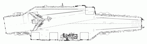

Yeah, about that... not a chance in hell. I cobbled together an NX-2 sitting on the deck of the USS Ranger.... the aircraft shown in your photo is a *lot* smaller than the NX-2 (note that the model shows the planes fitting on an elevator, something the NX-2 would be entirely incapable of). Now, it could be that it's a legit photo, just not showing the NX-2. Convair had ideas for a much enlarged vehicle using some design elements from the NX-2, known as the "Dromedary;" it's possible that they also saw merit in a scaled-down vehicle based on NX-2 aerodynamics.
Ranger is 1039 feet long; span of this particular NX-2 design is 133 feet. Feel free to check my work, I might have made a math error.
Nepa Ball! I love it...
Apart from the sizing question – and the engine alone of a NX2 is going to weigh 100,000-146,141 lbs which is well over the max tolerances of the flight deck – one must ask why? The whole point of WS-125A and the ANP was to produce an aircraft with range limited only by crew and platform endurance, not consumable fuel. So you could have a single base area and operate anywhere in the world. So why would you need a carrier?
USN involvement with the ANP program was focused on an engine for the Martin Seamaster seaplane. Perhaps after this was cancelled and the sea based striking force died its death Convair might have produced the carrier ANP to generate some USN interest?
on question for take of NX-2 from aircraft carrier
so far i know, NX-2 used during takeoff ZIP-Fuel aka High Energy Fuels HEF (HEF-3 ethyldecaborane ?)
for high trust and use the boron rich fuel as absorber of neutrons, in nuclear-powered airplane
But HEF is very toxic and does ugly things with jet-engine
so takeoff and landing with toxic HEF and maintenance of the nuclear engine and jet-engines
make the flight deck of USS Ranger one of dangerous Workplace on earth
The carrier deck photo appears to be legitimate (and a lot of work went into building this model). The caption was transcribed, including the NX-2 designation. Aside from that, I agree the whole idea is bizarre, illogical and probably unfeasible.
Even if this is a scaled-down NX-2 airframe, as it appears to be, it is still a nuclear-powered air vehicle. Why lug it around on a boat, when it can go anywhere across the globe, better and faster, under its own power? In addition to the the impact of carrier landings on the deck itself, I also wonder about subjecting a nuclear reactor to the stresses of catapult launches and arrested landings. And finally, an indirect cycle engine uses NaK in the heat exchanger -- which happens to be highly explosive when in contact with water. Another reason to keep this airplane away from the ocean.
Agreed. It well matches other, similar Convair reports from the time in format, use of a photo pasted to the page, and style of models. Either it's legit, or someone went to a stupid-lot of effort for a hoax of no particular value.
The NX-2 was to be equipped with several possible engines, including two sets of GE engines that married one reactor to two turbojets... for a total of two reactors and four jets. It looks like the mini-NX-2's here used a single reactor with two jets, which makes sense for a smaller vehicle. But a nuclear aircraft on an aircraft carrier is pretty damned silly.
