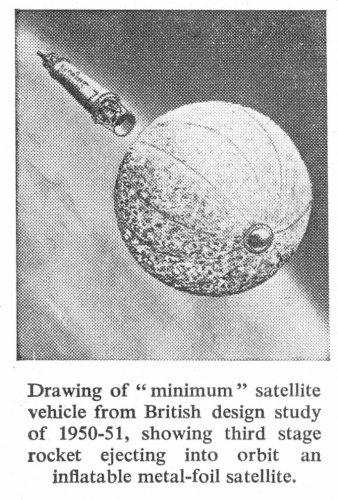

Thanks for the referances, will read tonight, The first Balloon Sat proposal that I am aware of was a BIS early fifties, illustration used in RAF flying Review article at a later date.
You misinterpreted that. It is: balloons that can be used for observations, and satellites that can be used for observations.
Hi Barry,
Yes, thanks, that is the one I was thinking off
