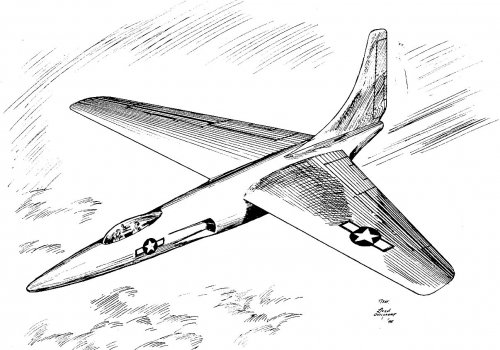

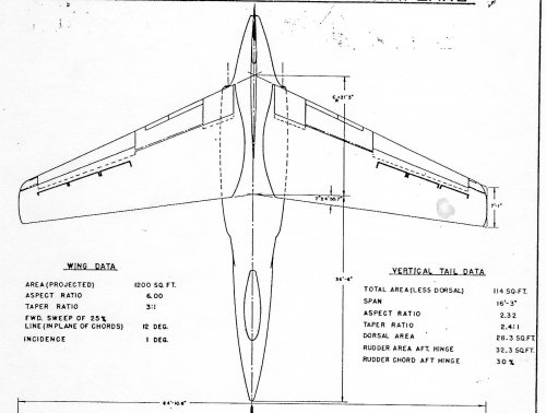

The earliest graphics I've been able to find (see below) on the XA-44 show that the amount of forward sweep was initially limited to twelve degrees--slightly more than AMC's piston engine-powered MCD 391 design, but much less than the final iteration. The GALCIT wind tunnel staff evaluated the twelve-degree arrangement in a report dated 15 May 1945 (GALCIT Rpt 479), and the 3-view below was included in that document. Minor changes followed, resulting in the fuselage being slightly extended in length from 69'5" to 70'9.5". That iteration is shown in the aircraft sketch below; it's from what appears to be an AMC report dated 15 January 1946. More to follow.
