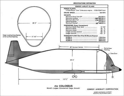

Artist's impression of Conroy Colossus a modification of the Canadair CL-44.
Conroy Colossus!
The world's largest commercial cargo aircraft will be constructed by Conroy Aircraft of Santa Barbara, Calif. Capable of carrying a payload of 65,000 lbs., the aircraft will have a cargo compartment 25 ft. 6 in. high, 25 ft. 2 in. wide and 113 ft. 2 in. long. A larger version of the company's previous modification of a Canadair CL-44, the Colossus is designed to transport airbus components and space hardware.

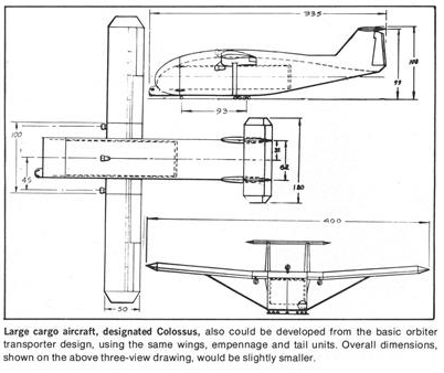

Available evidence says otherwise (see reply #9, for one, and the fact that the three-view referenced in the aerospaceprojectsreview.com link calls it "Colossus" *twice.*). If you have contradictory evidence, we're all ears. reply #8 shows a somewhat earlier Conroy concept also called "Colossus." It may well be that Conroy used the name twice. The later larger design was under the Turbo Three Corporation, a later iteration of Conroy's enterprise.
