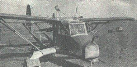

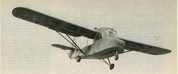

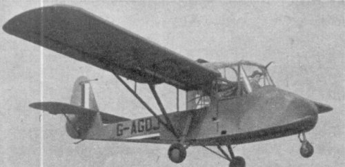

Just found while browsing through a number of mags (searching for
something completely else ...) : The Fane F.1/40 :
(from Flying Review 9/95)

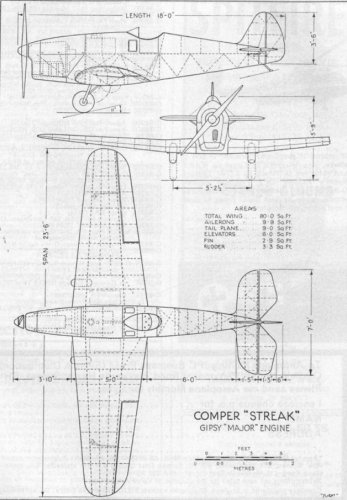

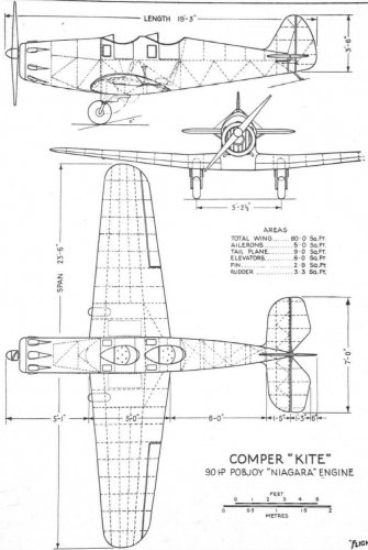

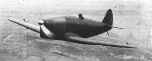

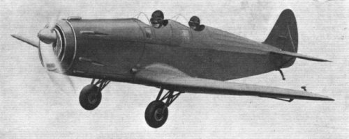

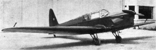

Hi! Streak and Kite.
http://aviadejavu.ru/Site/Crafts/Craft32644.htm
https://en.wikipedia.org/wiki/Comper_Streak
"The Comper Streak was a single-engined, single-seat racing monoplane built in the UK in the mid-1930s. It was not successful as a racer and only one was produced."
https://en.wikipedia.org/wiki/Comper_Kite
"The Comper Kite was a single-engined, two-seat touring monoplane built in the UK, derived from the contemporary Comper Streak racer. Only one was built."
Comper Aircraft Company
https://en.wikipedia.org/wiki/Comper_Aircraft_Company

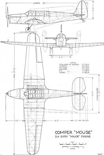

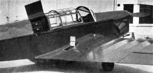

And Mouse.
https://en.wikipedia.org/wiki/Comper_Mouse
"The Comper Mouse was a 1930s British three-seat cabin monoplane designed by Nicholas Comper, and built by the Comper Aircraft Company at Heston Aerodrome in 1933."
http://aviadejavu.ru/Site/Crafts/Craft34510.htm
