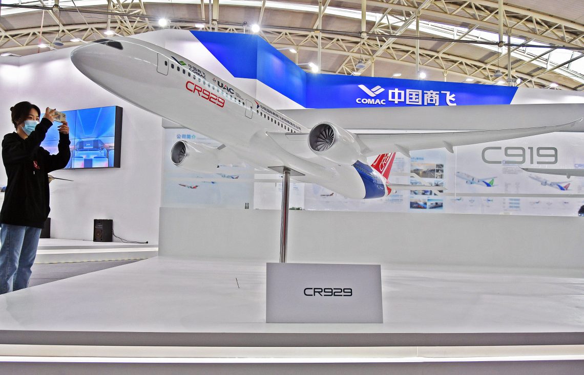

Rename topic to "CRAIC CR929". CRAIC for China-Russia Commercial Aircraft International Corporation, a joint-venture between Chinese Comac and Russian United Aircraft Corporation (UAC).
Just noticed, that the word "craic" is the Irish Gaelic term for fun, gossip, entertainment and enjoyable conversation between friends. ;D ::) B)

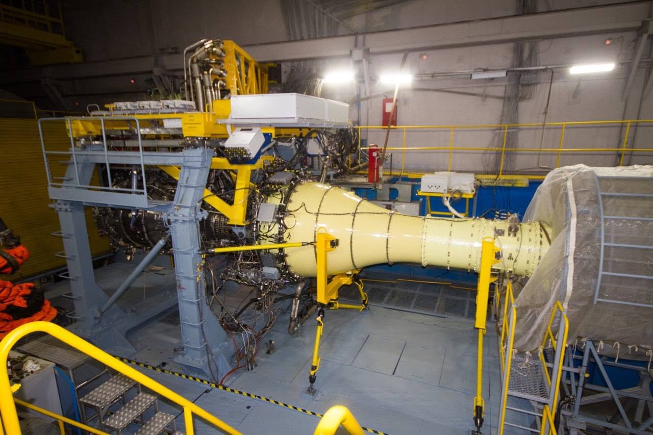

Russia, China partner for PD-35 ultra-high duty bypass turbofan engine
Published on Dec 15, 2017
Russia’s Rostec State Corporation will jointly develop the PD-35 aircraft engine with China. Confirmed at the Gulf Defense & Aerospace 2017 exhibition in Kuwait City, the announcement also provided details on the facilities tasked with development of the engine.
https://youtu.be/iWvQ9jc4dZ0
