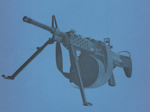

Colt CMG-2 LMG
there are also the CMG 1 ,Colt AR , Colt XM106 machine gun , Colt belt feed M2 HBAR and so many others.

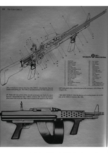

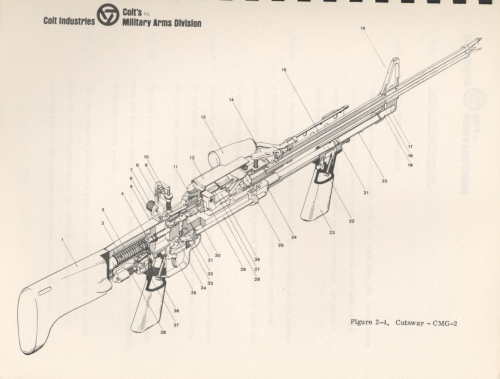

CMG-2 used a gas piston, not the direct gas system used by the M-16.
The operating mechanism is a combination from multiple previous types, though it had some original features:
  • The gas system was based on the M60
  • The feed system, and cocking, were based on the Czech Vz52
  • Ejection was similar to the Lewis gun
In retrospect what's interesting is that Colt recognized at the time that the 55 grain load for the 5.56mm didn't have the ballistics for the longer ranges expected of an LMG. Colt chose to develop a 68 grain load that was effective to longer ranges but could still be used with the same rifling as the 5.56 rifles firing 55 grain loads. This is in contrast to Mauser-IWK's contemporary 77 grain bullet which required a different rifling twist, meaning that the LMG rounds were not, strictly speaking, compatible with the squad's rifles.
This is all from Jane's Infantry Weapons 1976 BTW.
