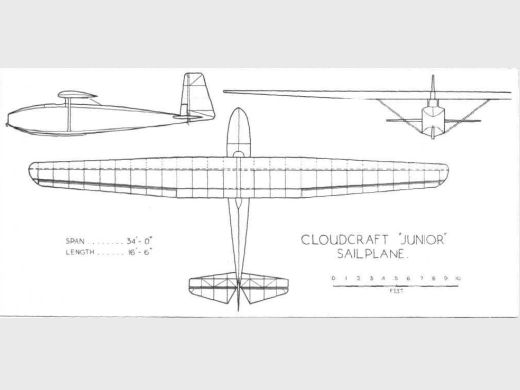

Cloudcraft Junior - (Project) 1931 single-seat sailplane
- Junior: Strut-braced, single-spar, stub-parasol wings
- Junior: Span 10.36 m; airfoil RAF 34 (modified)
- Junior: Constr. underway March 1931, never finished
-- Associated with the 1935 Penrose Pegasus sailplane [2]
-- https://www.j2mcl-planeurs.net/dbj2mcl/planeurs-machines/3vues/Cloudcraft_Junior_3v.jpg
