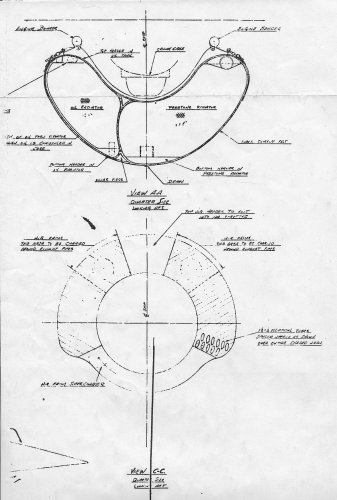

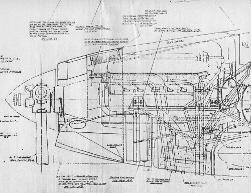

Does anyone have any info on CP35-414 (X-602) that called for a two-place pursuit? -SP
Here's a look at NAA's proposal. -SP
A few more...

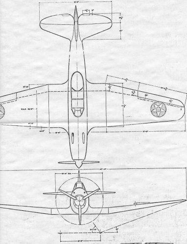

Very nice!! Thanks a lot for sharing, Steve.
The wing planform is exactly that of the T-6 series, isn't it?
Similar but not exactly - sure doesn't resemble the Mustang in anyway at all which came along five years later. SP

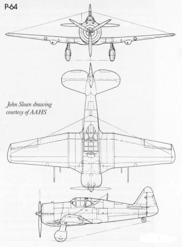

The T-6 wing outer sections were swept back. The "fighterized" version of the Texan, the P-64, had swept-forward outer sections, as can be seen from photos (I believe a P-64 still exists and is held by the EAA Museum, Oshkosh). I've never seen a plan drawing of the P-64, but it might make interesting comparison with this project.
From Norm Avery's 'North American Aircraft 1934-1998 - Volume 1'

I did a quick overlay in Photoshop; didn't bother to match scales or anything. The planforms aren't especially close. Distant cousins.

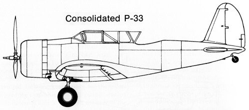

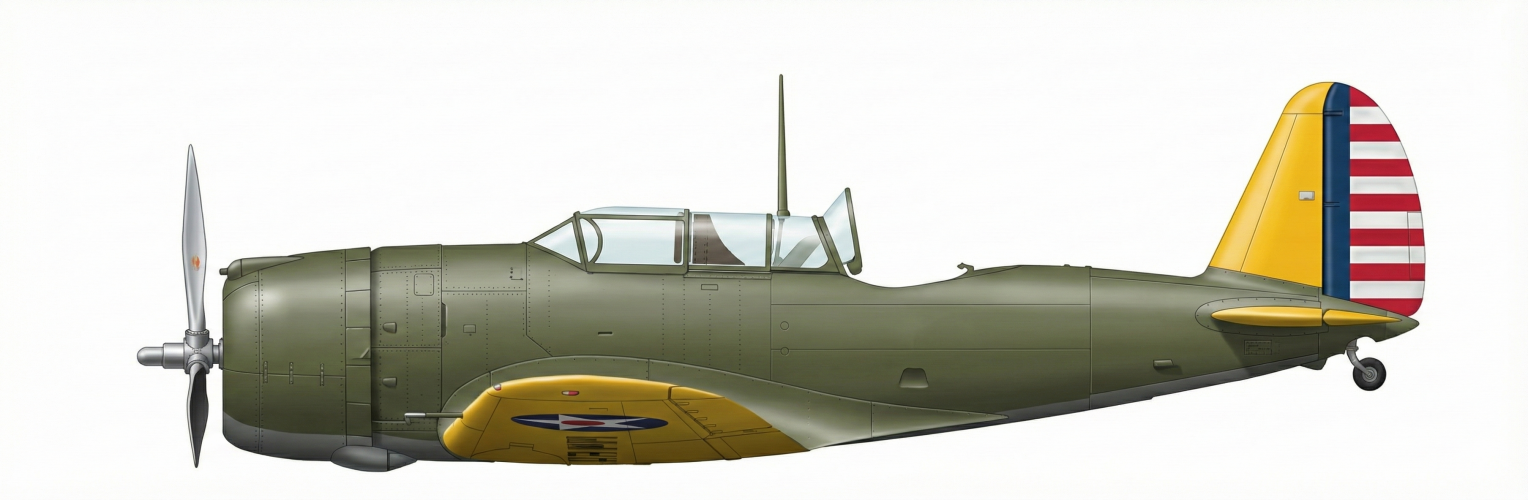

I have attempted to reconstruct what the XP-33 might possibly have looked like using a P-30 profile as a basis and fitting the R-1830-13 from a P-36A.
If the XP-33 was submitted against the X-602 proposal, then the XP-34 also must have, since they were competing designs. It might even be assumed that these two won over all the other contenders before the whole program was scrapped.

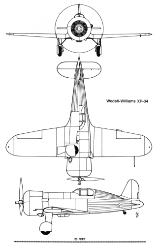

Now if the very first version of the Twin Wasp was to equip the Wedell-Williams XP-34, my assumption may not be quite appropriate, as the known three-view arrangement of the latter shows a very different looking engine (see attachment below).

In the book "U.S. Fighters" bt Lloyd Jones, Aero Publishers, 1975, is a profile of theP-33, in the P-30 chapter, page 76:

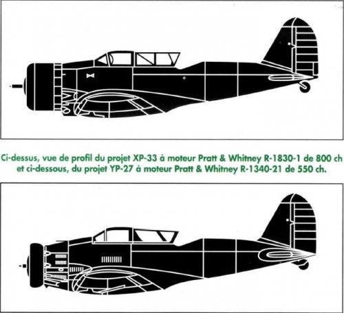

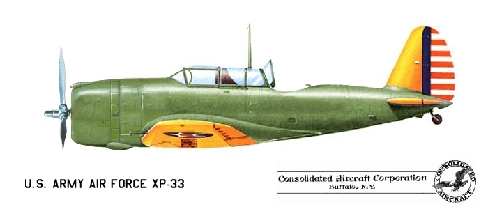

Maybe, Bellanca Model 27-86 (Two Seater Fighter-Landplane) is a competitor of the Consolidated XP-33.
from Le FANA 377,here is the Consolidated XP-33 and YP-27 drawings.
