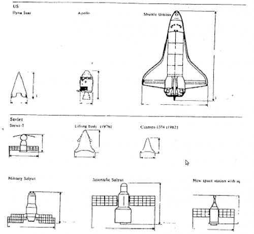

Specifically, on Figure 1. Absent from the "US" side are Mercury & Gemini; absent the Soviet, Vostok/Voskhod. Present, however...well, take a look:
http://fas.org/irp/cia/product/sovsta82.pdf
Oh very interesting a lifting body craft is listed new to Soyuz.

The Kosmos 1374 flown in 1982 of course is the BOR-4.
It's the third Soviet spacecraft, the smaller lifting body in the graphic.
Ie Soyuz, big lifting body, small lifting body.
What's the 1976 lifting body? It might be the Spiral of which BOR-4 was a 1:2 model.

So what's with the difference in content between the upper part of the above diagram, and the lower? The latter consists *exclusively* of spacecraft that had in fact *flown* prior to 1982 (the document's date of publication). Excluded are Vostok and Voskhod, which might be considered "developmental," not "operational."
The upper part of the diagram? Quite different...according to public record. Excluded...consistently...are Mercury and Gemini. But *included* is a "non-flown" vehicle. Which begs the question: why? And turning to the text, what exactly rated censoring, circa 2000 (the document's date of declassification), about the anomalous element of the upper diagram?
I'm not being coy to be cute. The possible answer rather gives me the creeps. I'd welcome a (similarly coy, if you please) alternate theory of what's being presented here.

Incompetance, laziness, lack of understanding of just what was supposed to go in the illustration, someone screwing around, etc.
Umm the soviet "1976 lifting body" has not flown AFAIK, only the smaller "1982" BOR model. Probably Dyna-Soar is there just for comparison, as a small shuttle style craft.
As the document states, these diagrams are for size and comparison purposes. They are not presented to showcase US and USSR manned spacecraft, but instead illustrate representative US vehicles that are similar to the projected Soviet designs.
The vehicles are (as noted above):
Lifting Body (1976) = MiG-105 Spiral first flown subsonically in 1976
Cosmos 1374 (1982) = BOR 4, an unmanned subscale vehicle of a manned concept flown between 1982 and 1984 as Cosmos 1374, 1445, 1517, and 1616.
Shuttle (late 1980's) = Shuttle Buran, only unmanned flight Nov 1988
Space Plane (1983) = Text says "...Soviets may introduce," a spaceplane similar to X-20 for station resupply and orbital reconnaissance. The US was insistent that the Soviets were developing the Uragan spaceplane (a design based on the Spiral). However, the Russians still maintain that this program did not exist.

1-You're overinterpreting the document. These things are included to be illustrative, not exhaustive. It's clear that they picked some of them like Dyna-Soar and Apollo because their size was roughly equivalent to the Soviet ones. Once you've included Apollo, you don't need to include Mercury and Gemini.
2-Dyna-Soar was undoubtedly included to be illustrative, to show that the US has looked at winged spacecraft like the Russian ones before. As for stuff being deleted, don't read too much into that. You'd be surprised at how often they delete information that turns out to be pretty darned boring. Sometimes they do it simply because it came from another report with a higher classification level. For instance, they might get the information on the existence of a vehicle from a Russian magazine, but the dimensions come from a classified Russian military journal that somebody in Poland stole from the military library and sold to the CIA. Different source, higher classification level, and it gets deleted.

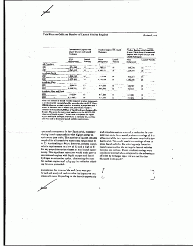

Go to the CIA FOIA site I listed earlier and search around. Type in "Mars" or "space" or "satellite" as a search term and see what shows up. There are several dozen reports similar to that one available. Once you figure out how to navigate the site it's pretty easy to use.
Unfortunately, the CIA didn't make it easy to download the documents as pdfs. You can only grab individual pages. Here are the pages from their report on "Soviet Options for a Manned Mars Landing Mission."
Here's the rest of the Mars assessment.
