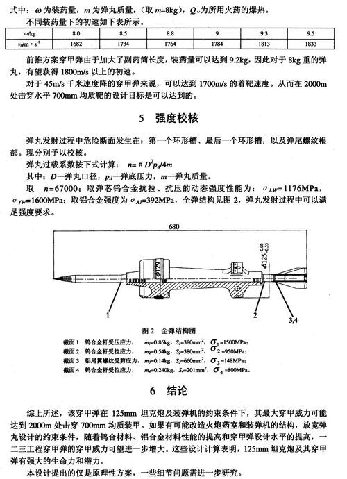

The article also mentioned a plan to increase the propellant cartridge and increase the amount of propellant to 9.2kg. The Project 123 using the new propellant is expected to reach a muzzle velocity above 1800m/s, thus penetrate 700mm of homogeneous steel at 2000m
