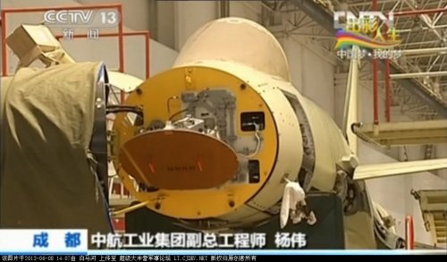

So, this is interesting. We finally have a few images of the radar on the J-10. Actually, there seems to be quite major differences between the prototype radar and that fitted to production J-10s.

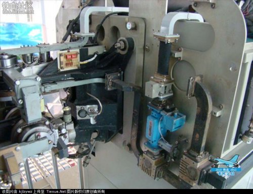

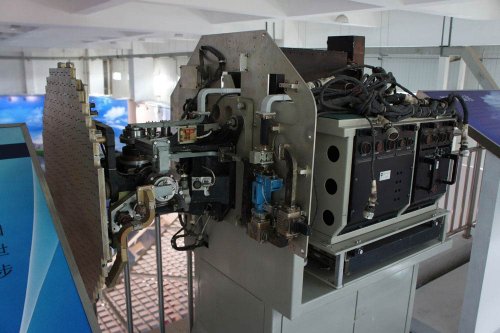

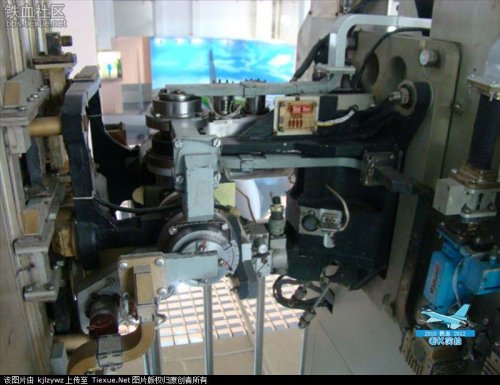

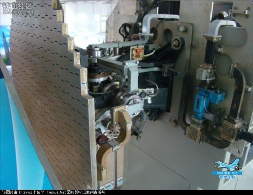

Here are some images of the J-10 prototype, and a radar which is displayed in a museum as "Type 1473". The antenna visible on the prototype is consistent with the antenna of the museum radar. The museum radar look very much a prototype itself.

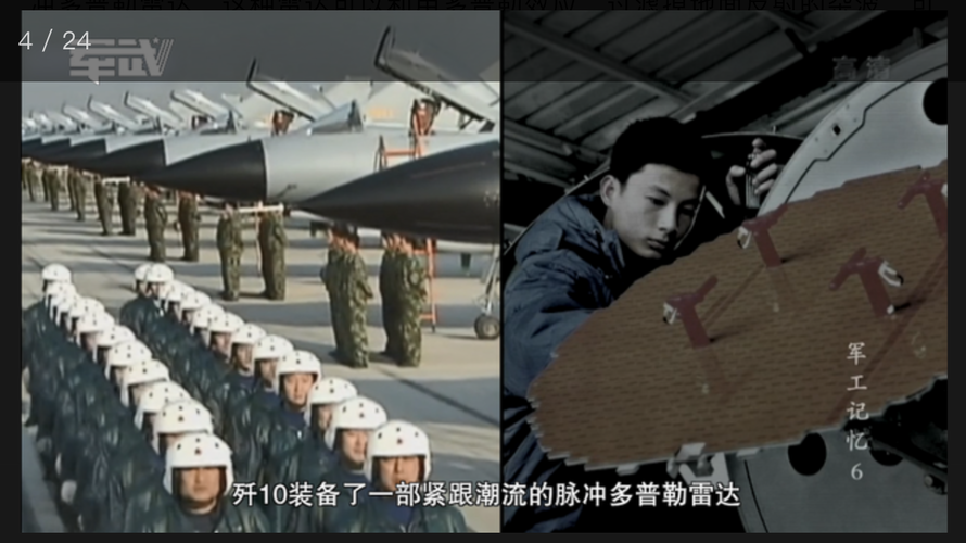

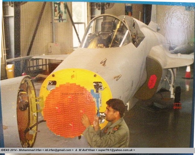

Here's some shots of the radars on production J-10s. The antenna design is different. Its got the IFF dipoles added, but the antenna looks smaller (?) and rounder.

Good point ! Otherwise it is surely possible and can be explained since the eraly J-10A used the KLJ-3, whereas the latest block - and I think You second batch of images are quite recent ones - have reportedly an updated KLJ-10.

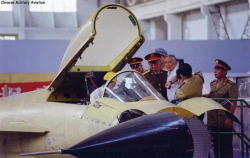

1991 metal prototype, appears to be something else as well. I don’t think the KLJ-3 prototype would exist for a few years.
