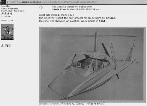

A long time ago, dear Jemiba posted this picture. Does somebody know if it would have been roadable or not?

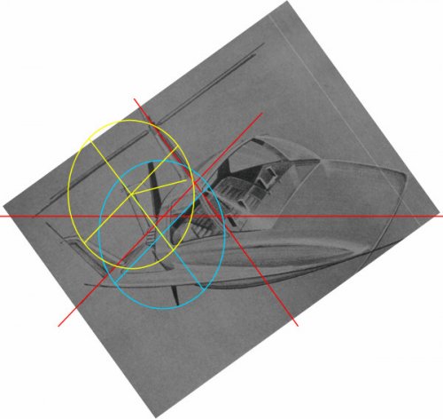

According to my calculations, modelisation, the propeller rotating would break the booms apart. How could this be?

A bit cheap, but generally correct answer: how could *this* be?
The keyword is "drawing". It seems that it is the drawing that represents the general idea, not all the details and technical solutions. Also note that at least I cant see there any shaft from the engine to the rotor.
Thanks Matej, I had not noticed the window at the rear of the cockpit, with no shaft there nor below the rotor.
Well, I imagine a solution: in fact the engine and propeller axis were one or two feet higher, with a direct (almost horizontal) link to the rotor, and just the blade tips needed a hole to rotate freely thus lateral booms. The artist made it wrong, but maybe more pretty, this is art... No?

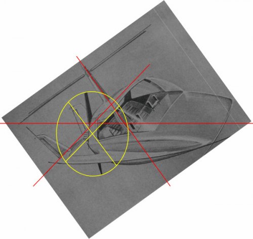

As an autogyro, it wouldn't need a shaft to power the rotor: http://en.wikipedia.org/wiki/Autogyro
Martin
Though it would be a bit corny, there is another possibility: the propeller at the back tilts underneath the fuselage when in the air, working as an counter-rotating rotor. When landing, it stops and tilts back between the booms...
Your idea is fascinating, yes! ??? :D
While... I doubt the length is big enough for the blade above to go down without breaking the tailplane, or even the boom/tail contact if the blade is set at 45° (or 60°) before the moving occurs.
But this looks like brainstorming for us. Very pleasant, thanks a lot! ;D
