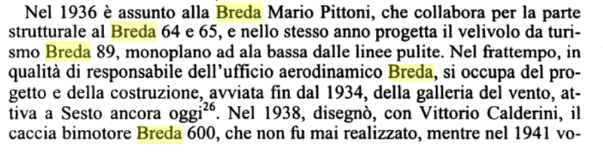

Nice find dear Jjr,
and that Info was from me,I got it from Net,and maybe that was the source,
the Breda Ba.18 was a monoplane prototype,maybe light aircraft;
Also mentioned Breda Ba.89,a low-wing touring monoplane and Ba.600
which we spoke about it before.

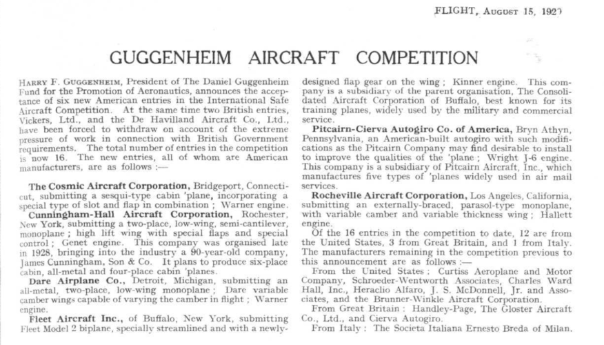

In "Gli Aeroplani della Caproni Aeronautiuca Bergamasca"page 5:
the experimental aircraft Breda 18 (built for participation in the "Guggenheim Safety Competition 1929-1930).
M.M.133 mentioned Breda Ba.18 with as engine 1 x Walter Mars.
In 1928 Breda built the Breda Ba.15, there are two possibilities, the Ba.18 was based on the Ba.15 or an new design.

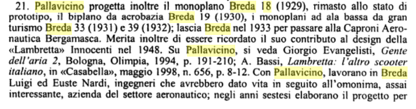

Hai
On the Wikipedia site of Pallavicino is mentioned that he worked for some time for Breda.
There are two projects mentioned of which I have, until now, nothing found.
The projects are the Ba 18 and Ba 35.
Concerning the Ba 18 is mentioned on the Breda designations forum that it was possible a light plane.
Who knows/has something concerning these projects?
They were not a projects,but actually built ?;

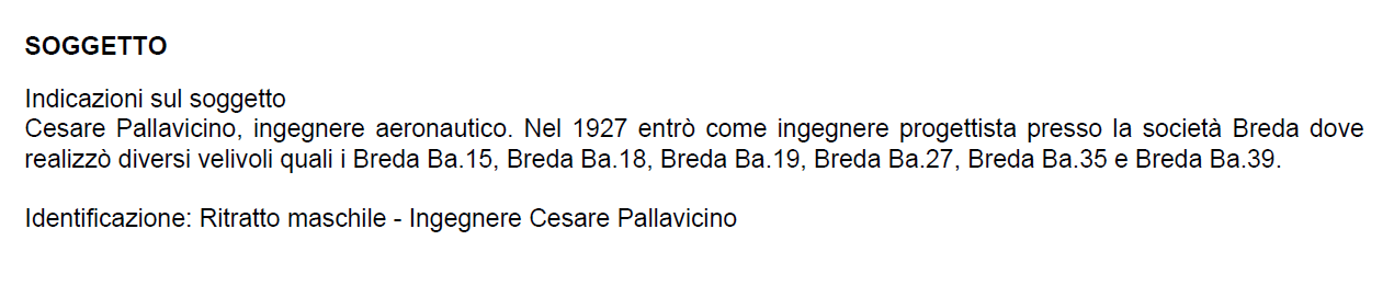

Information on the subject
Cesare Pallavicino, aeronautical engineer. In 1927 he entered as a design engineer at the Breda company where
he built several aircraft such as the Breda Ba.15, Breda Ba.18, Breda Ba.19, Breda Ba.27, Breda Ba.35 and Breda Ba.39.
I think for Breda Ba.600,the number "600" was not for a designation,but for speed,and after check from
Breda list,I suggest it could be Ba.203 ?.
