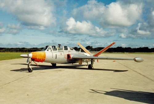

CM.160 - (Project) 1949 Fouga jet primary trainer, led to CM.170 Magister
CM.170 - 1950 Fouga Magister trainer; designed w/ Eng Szydlowski of Turbomeca
- CM.170: Magister,; 3 prototypes (1952); 10 x pre-production aircraft (1955)
-- aka CM.170R ('R' for Réaction = Jet-propelled)
-- NB: CM.170 No 2 first fitted with cruciform tail; then with the 'V' type
- CM.170-1: Magister; 1955, 1st production version; 2 x Marboré IIA; 761 x built
- CM.170M Magister : 1956, CM-170 Marin; 2 x Aéronavale PoC a/c, led to Zéphyr
-- CM.170M aka as CM.170 Esquif ('Wherry')
- CM.170-2 Magister: 1960, 2nd production variant; 2 x Marboré IV, 137 x built
-- CM.170-2 prototype designation may have been CM.209 (qv)
