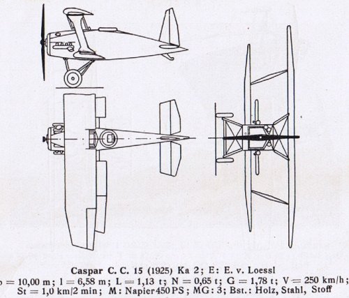

Making a study of Caspar aircraft , I came across a project
( Caspar CC 15 ) of 1924 , a torpedo aircraft with a crew of 2
, anyone knowing more , or having
a drawing?
Source ; Die verbotenen flugzeuge 1921-1935 Heinz J.Nowarra
The only pic I know : from " Taschenbuch der Luftflotten " 1926
Not to be unhelpful but that doesn't look like a torpedo aircraft. The undercarriage struts would inhibit centerline storage.
I agree .

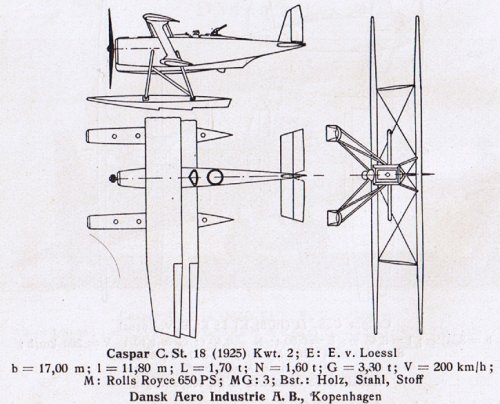

I think that the torpedo aircraft is the Caspar C.St.18 shown in the same " Taschenbuch der Luftflotten "
BUT the Caspar designations are very confusing :
- CI 14 single seater for Langsdorff is CS 14 for Green and a 2 seater for Lange
- CS 14 for Langsdorff is CJ 14 for Lange and CI 14 for Nowarra
- CC 15 for Langsdorff is a land 2 seater ,but a seaplane for Lange
- CSt 18 for Langsdorff and Lange is a seaplane ,a land single seater for Nowarra (the Langsdorff's CS 14 )

Hello Richard ,
As far as I know , Caspar CC 15 is a torpedobomber with a crew off 2 ,
and the Caspar Cst 18 a fighter with a crew off 1 ,
the Caspar Cst 18 also used a undercarriage who was not so good for the use
off a torpedo ! ( The Cst 18 was a development of the CI 14 )
Source Die Verbotenen Flugzeuge 1921-1935

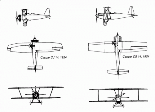

"CS 14 for Langsdorff is CJ 14 for Lange and CI 14 for Nowarra "

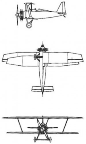

To make matters even more confusing :
Here are the CJ 14 and the CS 14, as shown in H.Stützer "Die deutschen
Militärflugzeuge 1919-1934" Both were fighters, but I think, they have not
much in common, apart from the "C" and the "14" in the designation

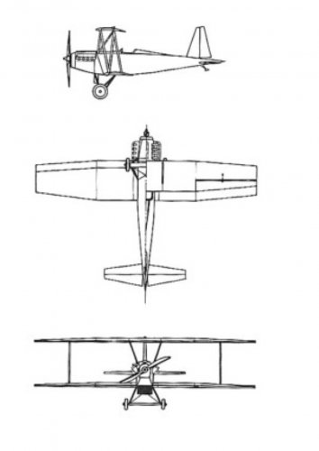

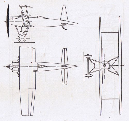

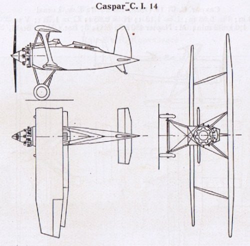

Hello
Looking closer in
-Taschenbuch der Luftflotten 1926
-Verbotene Flugzeuge
-German combat planes
-Typenhandbuch Luftfahrttechnik
I think that this could be the right ID ,but ,indeed ,I'm not 100% sure :

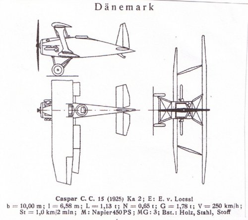

And the CC 15 lost somewhere on the net !
