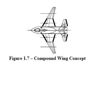

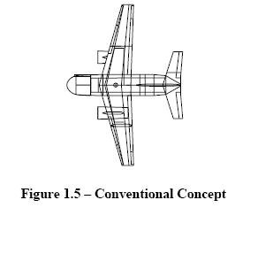

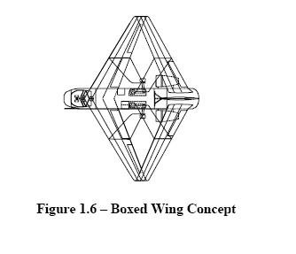

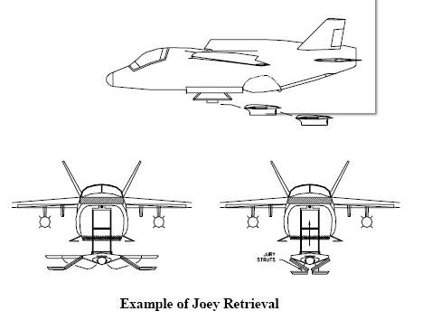

what about these
http://www.aoe.vt.edu/~mason/Mason_f/Vertigo.pdf
http://www.aoe.vt.edu/~mason/Mason_f/Chimera.pdf
interesting studies , wot?

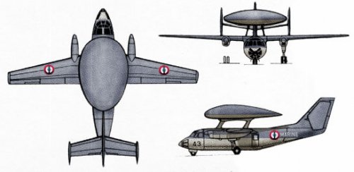

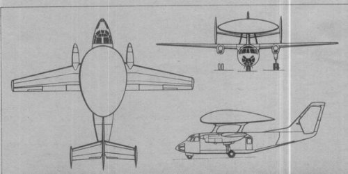

"An aircraft with STOL performance and long mission duration"
The french navy once considered an AEW version of the Dassault Spirale III,
STOL tactical transport, although its short field performance probably wasn't
the main reason for it, as it would have been launched by catapult from the
Foch/Clemenceau. But such an aircraft may be adaptable to being launched
from a ski-jump.
(From RAF Flying Review 4/1962)

avatar said:
what about these
