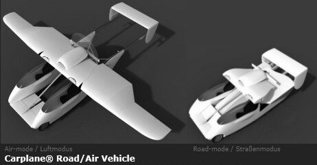

For the first picture I posted above, I gathered 2 views but not respecting scale. I think it is better below, transformed with Photopaint, still gathered but bringing the car-status to scale:
We must have for avoid the traffic ! :D :D

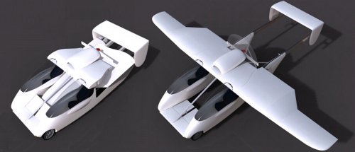

John Brown sent me the right picture without fake scaling down (below).
He sent also 8 other pictures, is someone interested to see them? may I post them here without Megabytes over-load or something?

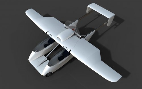

Tophe, you can upload it to Megaupload or similar and post here the link. Some member use this option for heavy weight file sharing.
Thanks for this answer explaining. Well I checked and Jpg-ed and that makes 7 pictures from 78KB to 125KB, the grand total being 664KB after I post this one. I will continue little by little I think. I used to upload on Photobucket but I feel uncomfortable putting them on my account as I am not at all the owner of them - here it is different: I clearly say they come from John Brown and I mentioned his web site, with other pictures.

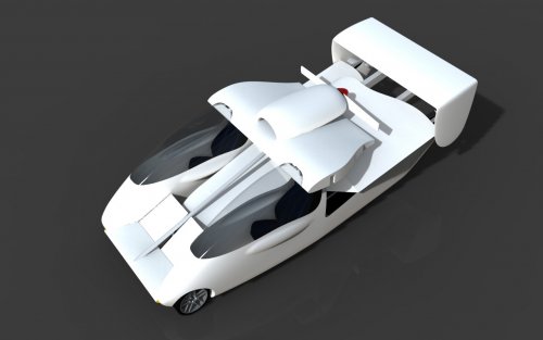

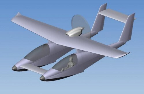

John Brown also directed me to something interesting : Rick McWilliams presented a project of homebuilt roadable amphibian similar to the Carplane in layout, see
http://www.homebuiltairplanes.com/forums/aircraft-design-aerodynamics-new-technology/10919-next-configuration-discussed-boomerang-configuration-other-multi-pods-2.html
