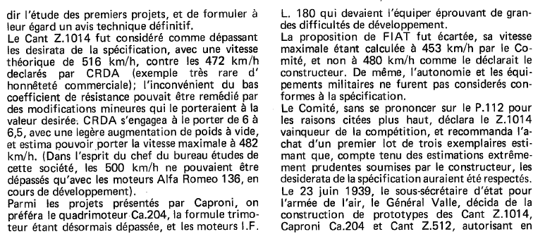

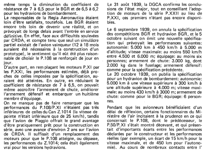

Great find MC72,
but why the Caproni series 200 are a little known,we know only 201,204,
205,211,214 and 225,there is nothing at all after that ?.
From, Le Moniteur de LAeronautique 1977-12.
