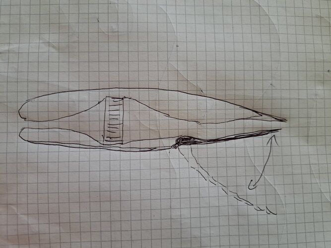

After reading and thinking about wing root intakes, canards and my carrier aircraft idea, I thought all of this could be combined.
As to my understanding, the canards are working with a higher inclination and wing load than the main wing, so that they stall first. Combined with the low wingspan of the canards, this will cause high induced drag by wingtip vortexes. The wingtips of a canard would be therefore an ideal place for wingtip propellers which can counteract the vortexes. Unlike positioning them on the main wing, the yaw control with one engine out would be much less problematic due to the lower wingspan.
The Do 28 ( https://en.wikipedia.org/wiki/Dornier_Do_28 ) wasn’t really meant to be a three wing plane and the rotation of the propeller was identical for both sides, but it could give an impression of how it could look like (with the wings more forward and a larger span). Same is true for this here
https://www.secretprojects.co.uk/th...livery-airplane-for-us-navy.39087/post-642513
The aerodynamic best solution for engine coolers is an integration in the wing. https://www.secretprojects.co.uk/th...hey-still-be-relevant-today.35041/post-643963
As written, this is easier said than done, because there is also other stuff in the wings, like wingspars, fuel tanks, flap mechanism etc.. Due to the lower wingspan, the canards, especially in a three wing plane, will have a significant lower wing root bending moment which would make it a lot easier to place the engine coolers integrated in the canards than in the main wing. This solution would also allow a split flap which would serve two purposes, managing the amount of cooling air flow and produce lift during landing and take off. The position in the very front of the aircraft will help to reduce the nose down moment. Please excuse the crappy drawing, but I think it makes clear what I mean:
Your drawing reminds us of the engine cooling radiators submerged in the wings of Messerschmitt Bf.109 and Supermarine Spitfire.
Others will tell you that Meredith radiators buried in the aft fuselage are the most efficient. At best, Meredith radiators neutralize cooling drag. Meredith radiators benefit from the huge volume available inside the fuselage to expand and slow cooling air flow to allow it the longest possible time in contact with hot radiator coils. BY that same logic, the longer the wing chord, the larger and slower radiator you can install.
But neither are really relevant until diesel engines become fashionable on airplanes. Diesels have the advantage of burning jet fuel, diesel fuel, home heating oil, etc. Multi-fuel becomes important as soon as you fly away from major airports in the middle of North America. Arctic bush pilots mainly operate turboprops because 100 octane low lead is scarce in Alaska or the Canadian High Arctic. Avgas can be even more difficult to source in deepest, darkest Africa.
Please note my last link in the post above, there I allready mentioned the cooling system of the BF 109 and also linked this here (http://109lair.hobbyvista.com/techref/systems/cooling/f_flaps.htm ). As we can see, the diffusor length was too short to be very effective, which was very likely the case because of the wing spars, weapons, landing gear and fuel tanks beeing in the way. Because of these constrains, the intake was at the bottom of the wing and not in the front, which would have been the best solution. Placing the cooling system in the rear fuselage ment to use quite the only area of a fighter plane which is relativly empty and allows sufficient space. The drawback is, that you need an intake with a boundery layer seperation which protudes out of the fuselage and causes additional drag. Also, the outflowing warm air will cause increased friction on the belly of the aircraft. Wing intakes can avoid this and are therefor aerondynamically the best solution, but mechanical constrains make them unfeasable in most cases.

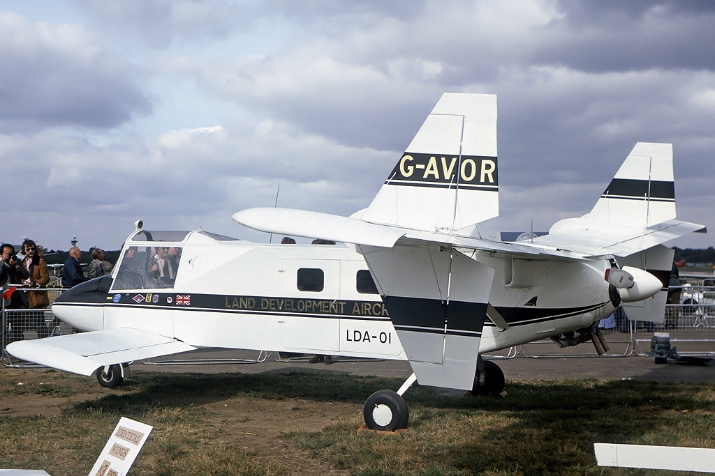

I'm reminded there was a light canard 'hauler' prototyped, name currently eludes me. Ex-RAF guy's name was long and unusual...
Aha !!
I'd call it a canard but, as canards' area equalled half a main wing, for better parts commonality, purists would say it was 'tandem'.
Straight, bolt-on, high-set wings, fixed tricycle undercarriage.
Sub-scale prototype had single rear engine & prop, but full-sized to have two wing-mounted, allowing tail-gate hatch., with load-space specifically designed to carry a couple of wings...
Yes, intended for bush / utility work. Not quite STOL, IIRC, but certainly 'short, rough field'.
IIRC, the big 'canard' allowed a 'prompt' pull-up to nose-high attitude for 'low & slow', the fixed undercarriage protecting rear prop...
As I recall, the sub-scale prototype had admirable handling characteristics, seemed to lack any vice.
Only snag was financing...
Okay, yes, the LDA-01 straddles the canard and tandem categories, but I feel it deserves a mention...
Like the unfortunate Optica, a STOL twin-boom pusher with helo-bubble cockpit, it was just too different, and unlucky besides...
Interestingly it was said, that the plane could work with a wide range of CG positions, that’s something which is unusual for Canards. I love the Optica, but this is unfortunately completely off topic…
