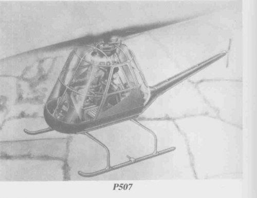

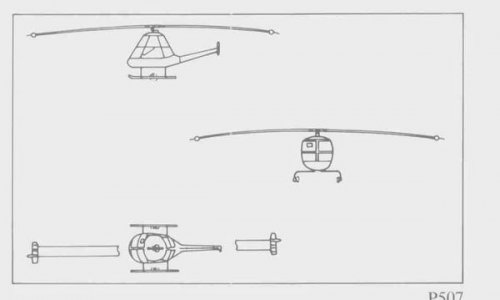

Bristol Type 190 => a drawing should be in the Putnam book "Bristol Aircraft since 1910" (2nd edition 1970) on page 374
Jemiba, is there a Saro P.507 drawing in Tagg & Wheeler's "From Sea to Air. The Heritage of Sam Saunders"? I cannot find my copy in the moment ...
No .... two of them ! ;D

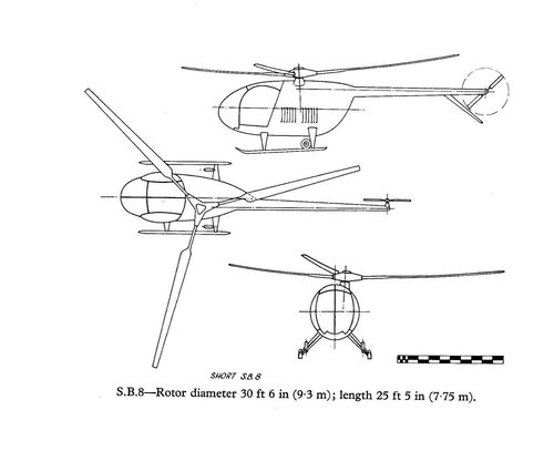

A three-view drawing of the Short S.B.8 entry for the HR.144T competition is given in the Putnam title "Shorts Aircraft since 1900" by C. H. Barnes on page 457. If anybody is interested in this drawing (and information too) please ask for it (but it will last a little bit longer because the scanner is buried under a pile of paper ...).
Shorts designed three further helicopters - the P.D.66, P.D.67 and P.D.68 (the last two in collaboration with Hiller). Can anybody help with artworks or drawings of them?

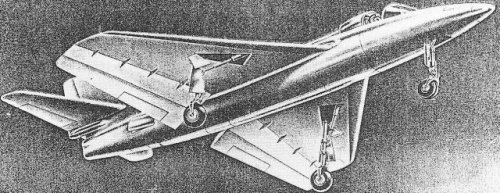

Image below (sorry about the poor quality).

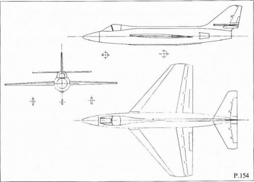

the SARO P.154.

Here's that GA from the above mentioned publication

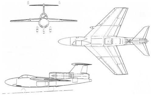

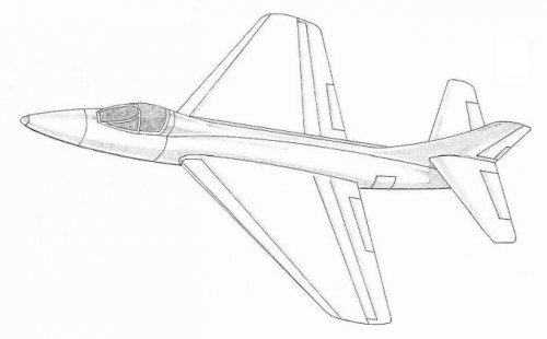

Hi! Saunders-Roe P.148
Crew: 2 (Sea Vixen type cockpit)
Power plant:
Avon RA.10R or RA.12 engine type
Dimensions:
38.5 ft (11.7 m) wingspan
50.0 feet (15.2 m) long
The wing area is 500 sq. m. feet (46.5 m2)
relative wing thickness 8%
Weight:
total 28,000 pounds (12,701 kg)
Flight characteristics:
Top speed
690 mph (1110 km/h) at sea level
Weapons:
Rifles - four 30mm Aden cannons
Missile - 72 unguided missiles
Source: TONY BUTTLER "BRITISH SECRET PROJECTS JET FIGHTERS SINCE 1950"
