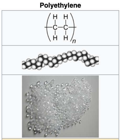

Plastics are polymers. Poly means many and mer means thing. Think of a chain made of many links for stretchy polymers. Think of chain mail linked in many ways for hard polymers. A common mer is ethylene
It makes POLYETHYLENE -- this is the most used plastic around. 100 million tons of it are made each year world wide. That's about 38% of ALL plastics made. 150 million tons of ethylene is made each year. Ethylene is a plant hormone and forces the artificial ripening of fruits. So 50 milion tons are used for that and 100 million tons are for plastics.

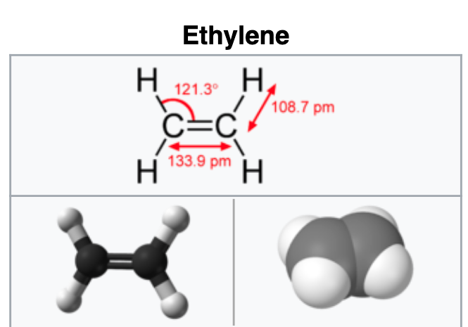

Ethylene is a plant hormone as mentioned. Microbes have been made and bred that produce large quantities of the stuff.

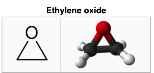

Ethylene Oxide is easily prepared from Ethylene using oxygen. It has a melting point of -160 C and a boiling point of 13.5 C. It was used in Germany during world war two along with hydrogen peroxide, as a rocket fuel. It is used as a disinfectant for heat sensitive materials. At room temperature is is a carcinogenic, mutagenic, irritating, anaesthetic gas. Yet is makes a dandy monopropellant. Combining both ethylene oxide and hydrogen peroxide in a combustion chamber makes a hypergolic combination.
A little pyramid made of hydrogen atoms at the base two carbon atoms in the middle and an oxgen atom on top.
So polyethylene is relatively easily converted into ethylene oxide and acetylene again. Ethylene oxide is a known monopropellant.

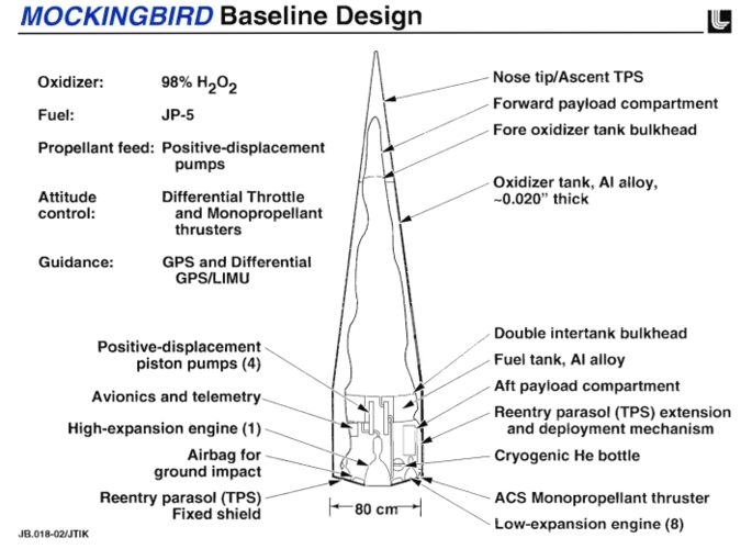

My friend Jordin Kare worked at LLNL back in the 1980s and 90s and project Mockingbird use H2O2 oxidizer with RP1 fuel. Rocket Lab's VLM is very much like this imho.
Putting up a nano satellite quickly from anywhere in an uncharted orbit to surpise an enemy, stay up one orbit and land at the launch site, with surveillance data that is never radioed anywhere, provides a substantial covert capability.
98% Hydrogen Peroxide = non toxic?
Kerosene = non toxic?
Afraid, not so on planet earth. (Just try putting 50% concentrate HTP on a bit of your skin and you’ll understand)
Also at those very high concentrations, HTP can experience spontaneous deflagration even without the presence of a fuel.
