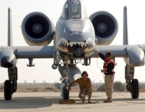

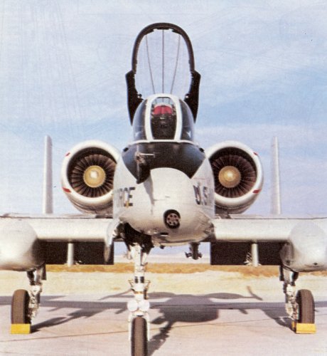

The #1 and#2 A-10 prototypes were fitted with a 20mm gun instead of the 30mm GAU-8......
From 'Air Enthusiast' May 1974, page 222,
'The A-10 prototypes.....differ from the proposed production standard.......
20mm in place of 30mm gun...'
photos to follow...
cheers,
Robin.
Here they are....
A comparison between the #2 prototype and a production A-10.
cheers,
Robin.
