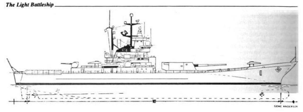

That would be something like Anderson's light battleship (11.000 to 14.000 tonnes) with a stealthy superstructure, 1 turret x 3 x 16"/50 guns, 90+ vertical launch tubes, and 2 x helicopter facilities and launch pad.
The lovers of big guns here are really hankering after a monitor not a battleship.
The battleship's ship killing role has moved on to subs and aircraft carriers or destroyers with missiles. The gunnery support for amphibious assaults which some still want is the job of a monitor.
