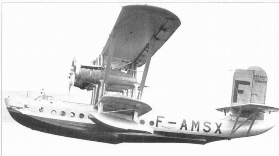

Breguet had built 3 different models: Calcutta, Bizerte and Saigon.

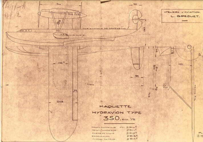

In January 1928, Breguet proposed a family of seaplanes:
- Breguet 340: flying boat with Short-type hull, 2 Lorraine 18Ka 650 hp, or 3 Renault 12Kg 550 hp, or 4 HS 12Ja 350 hp, or 4 GR 9Aa 380 hp
- Breguet 350: variant of Breguet 340, with 2 Lorraine 18Kd
- Breguet 360: military catamaran seaplane, full steel type with 3 engines
- Breguet 370: civil version of Breguet 360
I attach the Breguet 350 wind-tunnel model as example.
Does that mean the designations 340-370 were reused later on? I have them for completely different types...
This is a possibility. This is not the only cases of known designations reused for completely different planes, such as Breguet 510 or 600 for example.
