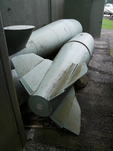

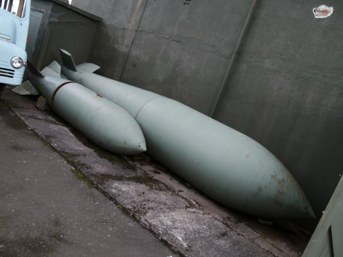

there are a few large unidentified casings at Dumfries aircraft museum, one in particular looks to be a slightly smaller 'Tallboy', il see if I can manage to upload some pics
pics from Solway Air Museum at Dumfries.
I have photos of the manufacturer's plates (Scottish Aviation) but they are a bit worn and don't tell (well, don't tell me) much.

the SAL. made casing at Dumfries & Galloway Aircraft Museum looks to be a British 22,000Lb Block Buster ? ref. https://bombfuze.net/gallery.html

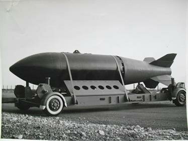

I was starting to wonder if it may have been connected with Violet Club due to the 'flip out' fins ? ref. https://www.google.com/search?q=blu...rlz=1C1CHBF_enGB853GB853#imgrc=HnRe73DFpKSV-M
Not really. Violet Club casings were simply modified Blue Danube casings with the flip-out tails manufactured at the former Blackburn Aircraft works in Leeds. Similarly, all the Christmas Island H-bomb test detonations all used modified Blue Danube casings for essentially two reasons. Firstly to avoid mounting additional and expensive ballistic drop trials for a new Violet Club weapon that was no more than a temporary stopgap weapon until Yellow Sun casings became available for Yellow Sun Mk1. Only 37 were built so drop trials for such a low production run would be unseemly expensive.
Secondly, for the H-bomb tests, the tested Blue Danube casings were large enough with minimal changes to accommodate anything that the Aldermaston boffins were likely to want to test, and thirdly to avoid any need for those expensive drop tests. As an aside, in the tail assembly shop, each tail bound for Christmas Is in 1958 had a topping out ceremony not unlike those done by builders of high-rise blocks of flats. Except the alcohol-free ceremony consisted of the workers leaving their signed fingerprints inside the tail skins. So every example shipped out to Christmas Island had my fingerprints on it.
The photo shows a flip-out tail, but it certainly ain't a Blue Danube tail. It isn't in proportion to the bomb. The BD tail measured 50% of the o/a length of BD that had a centre section much shorter than the photo at little more than the BD diameter of 62". The density of BD as compared with most iron bombs was much lower because they were not almost completely filled with explosive and other things. Much of the internal space was empty of anything except air at ambient pressure. The rest being used for the nuclear package and gadgetry. That low density was related to a number of difficult to resolve ballistic issues. Red Beard casings were similar in design but much smaller, and were produced in the same former Blackburn Aircraft plant.
